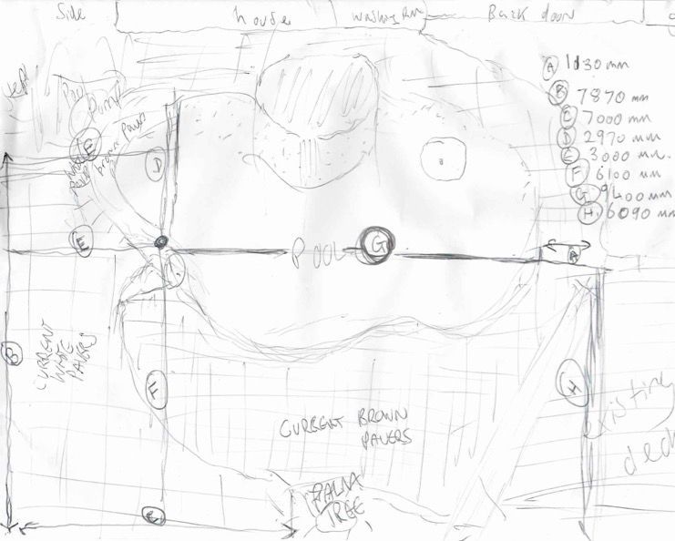

I did do a sketch, Im not much of an artist tho lol but its good to have something.
my rough planmy rough plan

Nice sketch to start with :smile:  Now you need a profile one to help you with the heights you have in mind.
I would suggest you need to remove those pavers to start with.
Then work with the ground level to the level of the deck you want.
If its to short as you have been saying then the question comes up how do I get enough height for air circulation under the deck and for the deck to be level. Also what to do with the excess soil if you have to remove some.
You currently have a couple of deck step/heights to contend with. I would take a baseline from the deck at your back door and then extend that line to the back fence.
It does seem that that second batch of steps with pavers will be high from the photos. But you need to factor in the step down to your pool. This is the stuff you can play with in your mind with sketches. You have a top down one, lets go side profile and also the profile looking towards the back of your house. This will show up the steps needed to get to the pool, the overall level you choose and if you can incorporate the "hill" that is towards the back fence. Even to the point of a higher raised garden bed you move the excess soil to (just an idea)
I am not sure what the measurements are refering to tho from rear of fence to edge of pool towards the house is 9m?
Some measurements that I couldnt figure sorry.
Width of rear of yard -
From the deck to the rear of the yard -
The height from water surface to the deck you would like and is safe -
Is the timber deck the same heigh as the pavers at the rear of your yard?
Just looking at the photos you have shown again, the new deck will stand out against the old deck by a fair amount I think. Are you considering redoing the deck under the awning?

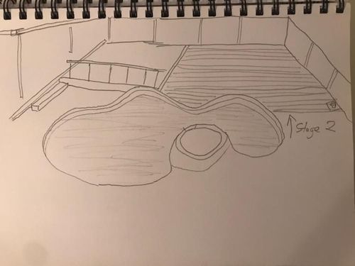

Stage one, dosnt have to match exactly what I have drawn, you could go further towards the fence if you wanted but id choose half way to make life manageable.  I would leave the stepdown area where you enter the pool as pavers. Would even switch them out for the more modern style ones you have at the back fence. They will handle water a lot better. The stage one decking would have a handrail so people are forced to take the step or you could have a step there as well. You could also pretty much deck up to 10cm from the palm tree itself.
When I was sketching it out it really sank into me that you will need to remove the pavers and escavate the soil so as to allow you to build the substructure for the deck. Even if you dont go with stirrups, bearer, crossbeam and then deck. You could get away with missing the bearers if needed.

Stage 2 is when you would have to dig out that soil under the pavers I think. (guessing the height level atm) You need to factor in the skimmer box in this section (a lid area in the deck above the box would work) I drew in that handrail next to the paved area also. I have used "Breakboards" (only just found out about the name lol) to seperate the stages plus make it look nicer.

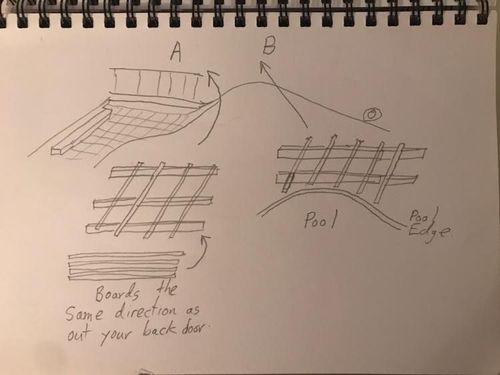

I am trying to show an exploded view of stage 1 (A) and then stage 2 (B) the way the beams are laid out is so your existing floorboards continue through to the new ones in teh same plane.
With B the edge of the pool and how the beams could overhang their supports by a little. I would not overhang by more the 200mm for the beams from a stirrup/pier. When you get to this stage I would actually lay them on the ground to get an idea on how you will work around the edge of the pool. I would also go for straighter lines so it dosnt look choppy.
