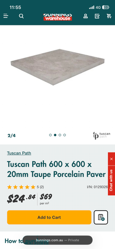

Can I use these pavers
I can't see any reason why you couldn't @Fro007. However, as with any tiles or surface that could be affected by heat, you'd need to follow the cooking appliance's directions regarding what surfaces it can be placed on. If the device outputs a lot of heat directly below it, you could risk cracking the pavers. The same goes for tiles, stone benchtops, etc.
