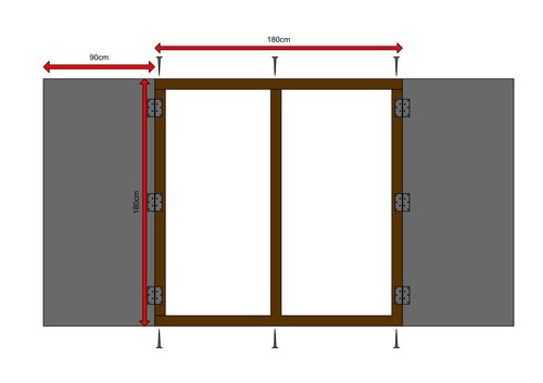

So I've been thinking that perhaps an awning cover would be doable.
With a couple of square posts bugle screwed into the house studs, with some heavy duty strap hinges at the top, and a 180cm square frame with some colourbond on top of that, and a stay to lock it into place, I think that would suffice until the day comes I can build a steel lean-to with a roof on it.

Re: How to build solar inverter and battery shade cover?
Hello @BoeingFan
It's great to see you back with another project on the go! I believe your idea of an awning is a great way to shade your battery from the heat of the sun. Plus, it will not cost you an arm and a leg to assemble. My best advice is to make sure that the wood that you use is rated H3 for outdoor use. I suggest using a flat piece of cardboard to create a mock-up of the awning, which will help you determine the ideal size and the most effective angle for positioning it.
Please remember to keep the recommended cover distance by the manufacturer.

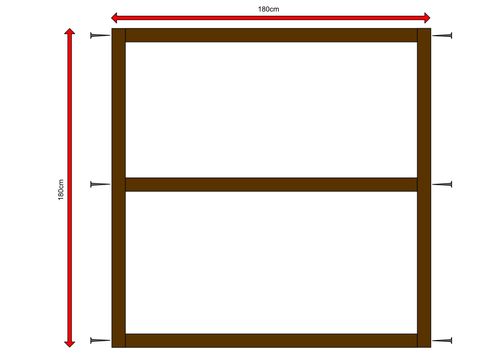

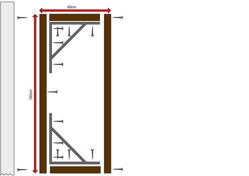

Thanks so much @EricL 😀
The other consideration I've thought about is to have a box frame which puts shade panels out front to stop direct sunlight, whilst maximising side airflow. My only concern with this style is that the weight of the timber fighting gravity may be its own worst enemy. A fabricated metal cage may be lighter, I'm not sure of that though. Here's some draft thoughts on that style.
Hi @BoeingFan
The plan looks good but would definitely build it with louvered type walls to promote airflow. Best advice as always is to do a cost analysis of the parts.

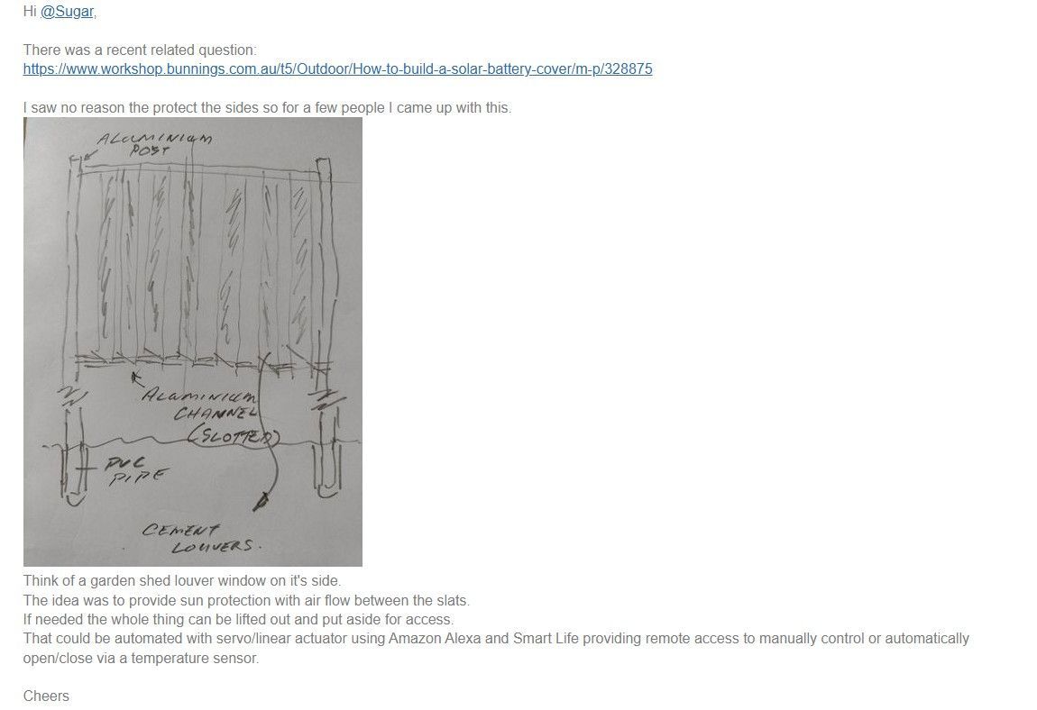

Hi @BoeingFan,
This was my suggestion.
Cheers
G'day @AlanM52
Thanks so much for your suggestion, I appreciate it.
The idea of cementing something into the ground has crossed my mind, but I'm cautious about it for 2 reasons. Firstly, and this is kind of embarrassing, but I'm completely green when it comes to measuring/digging/cementing/stabilising a new pole and making sure it's all the right heights. For some reason I just find it intimidating because I can't simply pull it out of the ground. Secondly, at some point I will have a carport/lean-to/verandah built on that wall and a permanent fixture in the way isn't ideal. I've already got a cemented in steel electricity pole to accommodate. Thanks again.
Concreting in a post is a relatively easy job, @BoeingFan. As long as you have a level to check plumb and a couple of timber sticks for braces, you typically have plenty of time with standard concrete to get things in the right position. Even with quick-set, as long as you take the time to get the post nice and straight before placing the concrete, there's not much that can go wrong.
