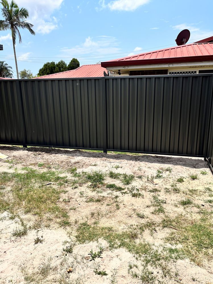

trying to work out what the best solution would be to fill in gap under the colorbond fence, I will eventually be laying river stones along that side of the fence and the gap creates an issue - i need something to fill it so the stones don't go through the fence onto the neighbours lawn, any ideas please? thank you

thanks for your response, the issue I have with timber sleepers is that they are 200mm high which means a lot of digging and there is a lot of concrete under the posts so then I would have to cut it, if it was done when the fence was done that would have been so much easier. I don't think you can get timber sleepers at 100mm high? I was thinking what about concrete garden edging or something similar this would mean I would just be able to level off the sand and put the edging straight down and would work when laying river stones?

thanks Jacob, the 100x25 sleepers H4 treated would work I think with garden stakes, definitely less work than the bigger sleepers! really appreciate all these options, the soil is mainly sand so I will need to test it out first I think, thank you
