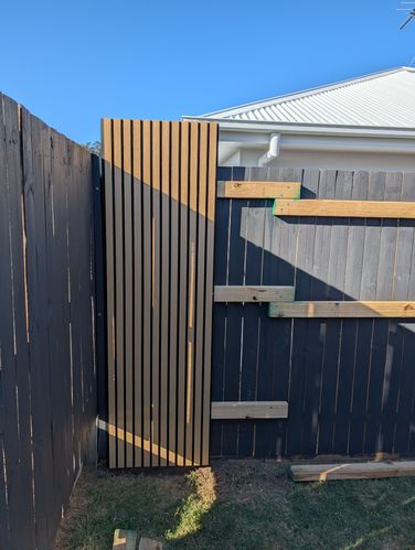

Hi! We are also doing something similar. From what we can gather from advice from others, we should be screwing horizontal supports into the established fence posts (3 of them in line with the established horizontal supports). We have chosen H3 45mmx90mm timber. Then screw the composite cladding into those new horizontal supports. Is this correct? I am concerned by the weight but would obviously like to avoid have to concrete in new posts. Thanks!

Thank you for your reply Eric! I'm not too sure what type of cladding it is, sorry!!
We did end up attaching horizontal supports to the established fence posts and then attached the cladding to those. Hopefully the weight will be okay and w don't get any leaning in the fence. I'm sure we will know soon enough!
