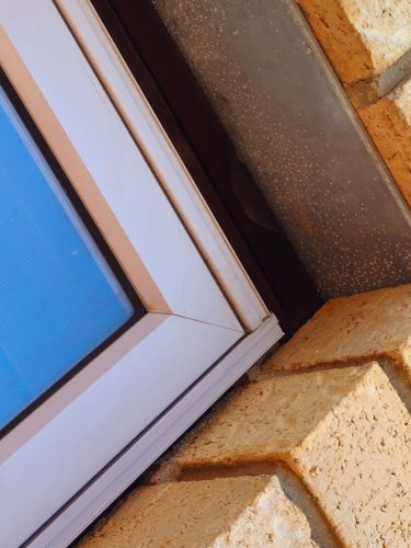

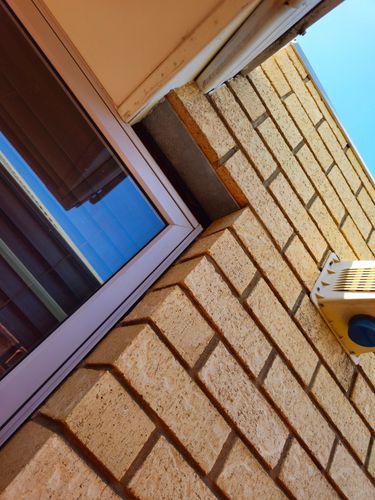

I've a large gap beneath the lintel and the upper side of the window frame. I'm not sure what the builder was thinking. Is there any solution to the situation. See the attached photo. The gap is about the height of one brick.

A good cosmetic patch would be to get a similar brick or a leftover piece in your shed and cut a thin profile using a grinder with a brick or stone cutting blade. You can then glue this piece into the gap using Selleys liquid nails and fill the surrounding space with Selleys 440g Medium Grey No More Gaps Bricks And Mortar Gap Filler.
However, if you don't have any leftover brick and wish to cover this gap, I suggest using a short piece of timber that is H3 treated. This will protect it from insect attack and can be used outdoors. You can use the same adhesive and filler that I suggested. But before you put into place, I suggest painting it the same colour as your brick wall so that it does not stand out.

My ideas pretty much follow @EricL 's tho instead of painting the timber option the same colour as your brickwork, maybe colour it the same as your eve? I think the brick colour will be less noticable if you get a match otherwise I would go for the off white eve colour.
