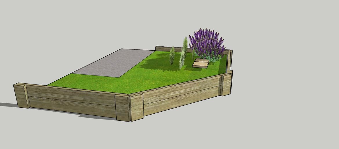

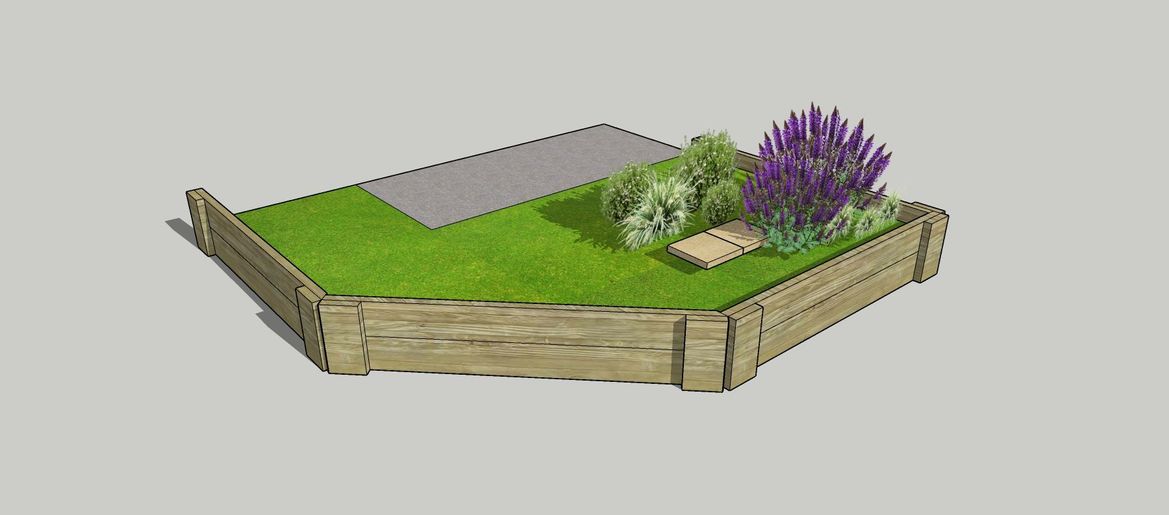

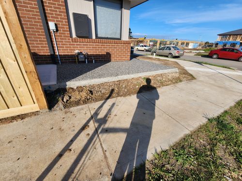

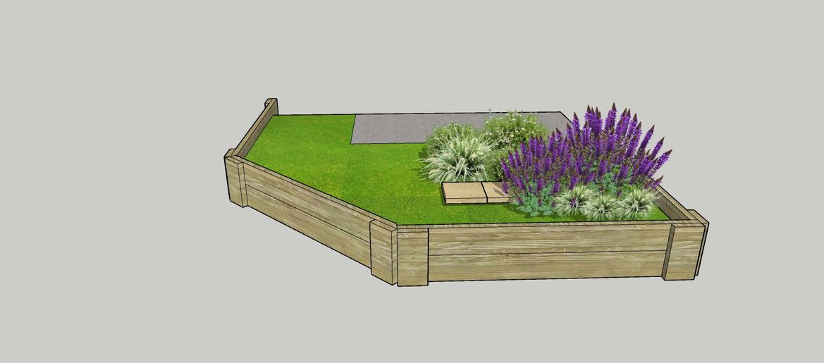

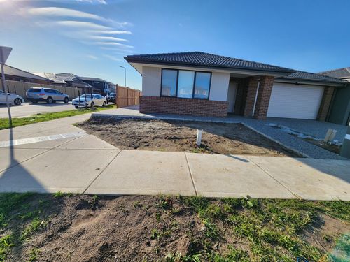

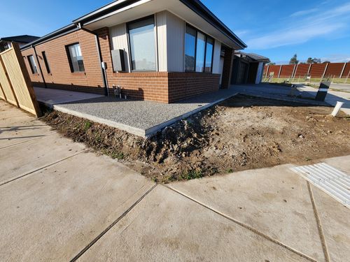

Hi how can i install retaining wall or boundary to my front yard there is big slop near to concrete
Plz advice with design many many thanks in advance

Good Morning @Sadiqxyz
:smile: Welcome to the Bunnings Community page, So many things in here catch my eyes so hopefully one you will like for a retaining wall idea.
My suggestion would be a Gabion Wall. A metal mesh bsket filled with rocks/stones/broken concrete even
80cm by 40cm by 40cm Gabion Basket and there are some different sizes for different configurations. Bunnings sells them and they are usually located down the back of the fencing isles/garden isles. They are incredibly easy to put together. They also allow free drainage through the wall. (I have used geotech cloth behind the wall to stop fines come through.)
Best bit for these style retaining walls (Low in height, wide in base) is that you can just have compacted earth/clay underneath them.
I have installed a bunch of different sizes, some pre-made some I made myself. They all work well.
Search for "Gabion" up above or here is a link where I have used the pre-made style of baskets. Corner gabion wall
Do you want a fence on top of the retaining wall or just an edge to have a flat lawn?

Afternoon @Sadiqxyz
Gabion walls would work well for that especially the premade ones :smile: I will be posting another low gabion wall for the edge of my path at home in the next day or so if you want to have a look.

Hello @Sadiqxyz
Thank you for sharing your question about how to build a retaining wall.
I suggest having a look at this guide - How to build a retaining wall by @Adam_W. You'll find some excellent tips on how to design your retaining wall.
I also recommend having a look at the RIDGI Reinforced Concrete Sleepers in combination with the Ridgi 50 x 50 x 3mm 0.9m Galvanised Steel H Joiner Post Upright Sleeper
Here is a link to their brochure: RIDGI Concrete Sleepers (contains installation instructions)
Here is a handy step-by-step guide: How to build a timber retaining wall
