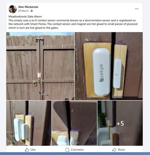

Pets are Precious - In my circles I am always involved with keeping pets safe and regardless of what the setup is I always try to include some sort of backup to warn of malfunction.
Amazon Alexa monitors the front gates via a Wi-Fi Door/Window contact switch.
If the gate is opened (or left open) she will send notifications to my phone 'Alan...someone opened the front gate' with repeat warnings.
With a front entry door/ flyscreen door in mind install a half height gate/barrier on the outside - self latching.
What about this?
Bunnings have them.

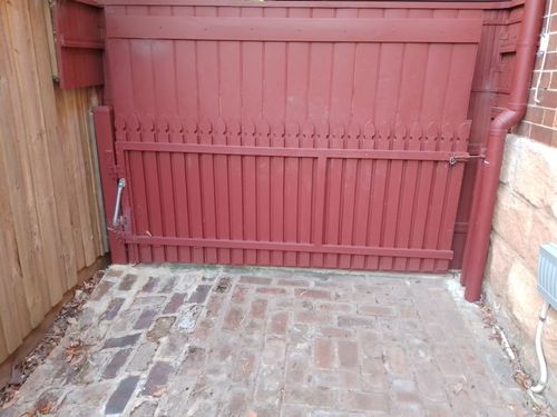

Sorry for the lack of photos. This is the gate from behind.

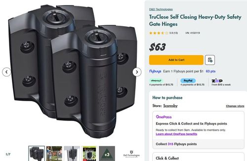

This one for 70kg.
Self Closing Heavy-Duty Safety Gate Hinges

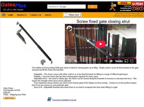

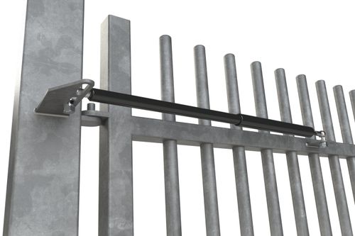

I found this one for 80kg gate.
Gates Plus GSB gate closer.

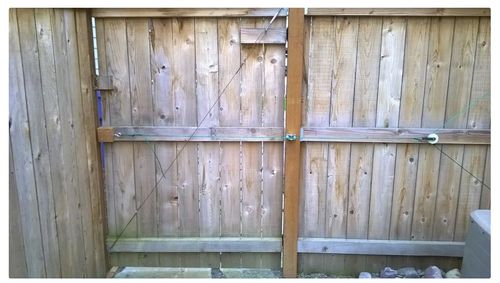

Weight Driven Gate Closer.

I like @AlanM52 's last link of his suggestion, The weight driven gate closer, it looks a little complicated but Would carry enough weight to close the 80kg gate. (Not sure about the spacing layout of the front of the gate. Using spindals and pullys will keep it narrow profile.
I would also suggest to add Easyroll 125mm 100kg Swivel Gate Castor to help with the load on the hinges. At the moment The gate looks good but with a little time it may sag. This will help prolong the life of it.
