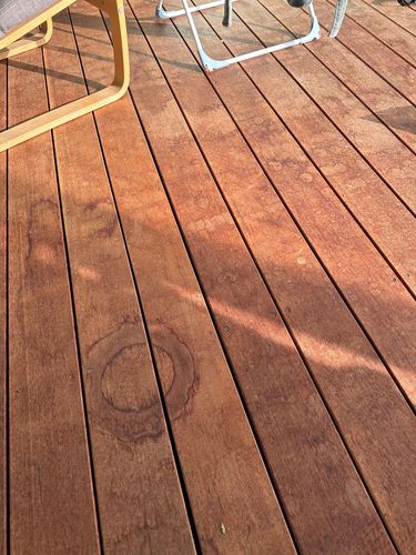

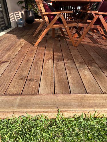

Hi Team, I built my Mebau deck 24sqm last year. Now I am planning to oil it for the first time. I need to maintain the natural look. Please advise the steps to follow. Below are some pictures. The deck is facing maximum sunlight. Thank you

Due to the deck being unsealed for a significant amount of time, it's looking a bit mottled, and there is some staining. I'd recommend you give the deck a good scrub down with Cabot's New Timber Prep and a stiff bristle broom and then allow it to dry. Using the preparation product will even out the surfaces and hopefully reduce that staining.
Next, you apply a Merbau-tinted decking oil as per directions on the can.
Now, I'd like to question what you're referring to as maintaining the "natural look". Currently, your Merbau decking has lost most of its colouring and looks dry and un-nourished. If this is the natural look you are referring to, then a decking oil will change its appearance. It will go darker and add colour back to it. If you have a look at this guide on How to build a deck you'll see in the last steps the application of an oil and the results. You can choose to use a natural decking oil that won't add a Merbau colourant. This would be a more "natural" look, but it will still nourish the timber. Nourished timber is always darker in tone than dry timber. If you apply some water to the deck, that will be a similar look to adding a natural decking oil.
