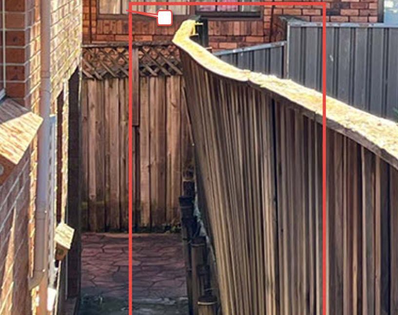

My fence and retaining wall were damaged by my neighbour's builder during the constructions works.
The retaining wall, posts and fence were deflected and damaged by the construction equipment and water leakage.
I want to restore them back to the original condition or reasonable standard.
What are the minimum requirements I need to check on the quote for the retaining wall and fence works ? eg. Materials and timber types etc ?
Some contractors have advised me that I need a new retaining wall and fence as they cannot be repaired. The fence will break once removed and it will cost less to install a new one.

The issue started in 2022, the builder damaged the fence and retaining wall underneath. I contacted the builder directly and they acknowledged responsibility for the damages caused and assured me that they would be rectified by the end of the construction.
However, once the project has completed, they denied any responsibility for the damages, claiming the fence and retaining wall were too old and at the end of their life.
I informed my neighbour about the issue since it started in 2022, but they have not taken any actions and seem to believe everything the builder has said.
I had no choice but to take the matter to the tribunal (NCAT) last year and now the tribunal ordered my neighbour to be responsible for the repair.
