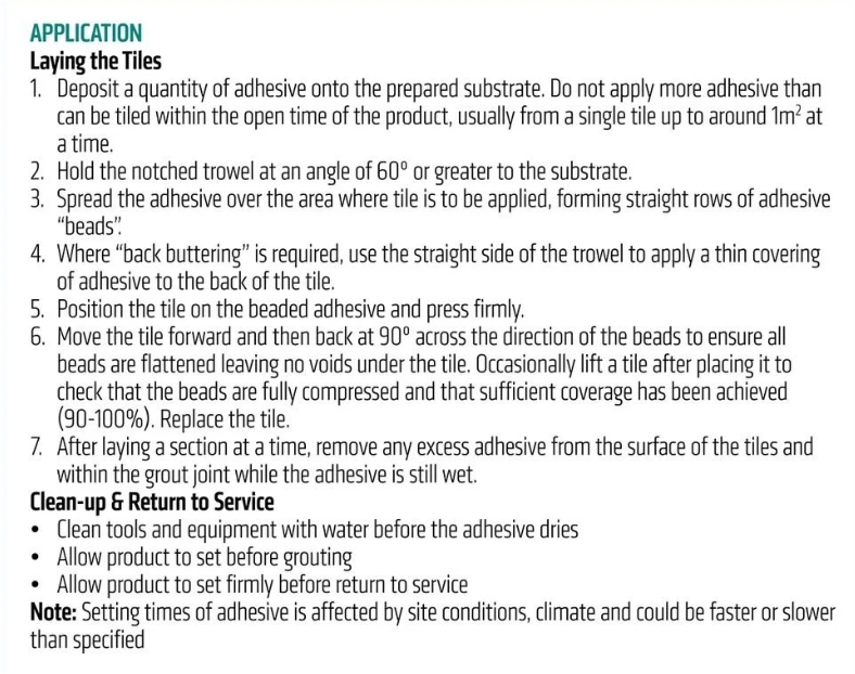

I had a closer look at the Davco Ultraflex, and it recommends 12mm max for tiles greater than 400x400. Would I then apply 6mm on the ground and 6mm on the tile?
The Davco Ultraflex recommends putting a primer down first, is this necessary? If so, could you please recommend a suitable primer for my exposed aggregrate? Thanks.
Prior to applying leveller in select areas, would a primer still be required before applying leveller?
Cheers,
Wei
Re: DIY tiling over exposed aggregate?
Hello @Wei123
The instructions for back buttering were very general, but it did mention to apply a thin covering only. It would be best that the majority of the adhesive be applied to surface rather than the tile. Remember to follow the installations instructions especially how the tile needs to be moved into position.
