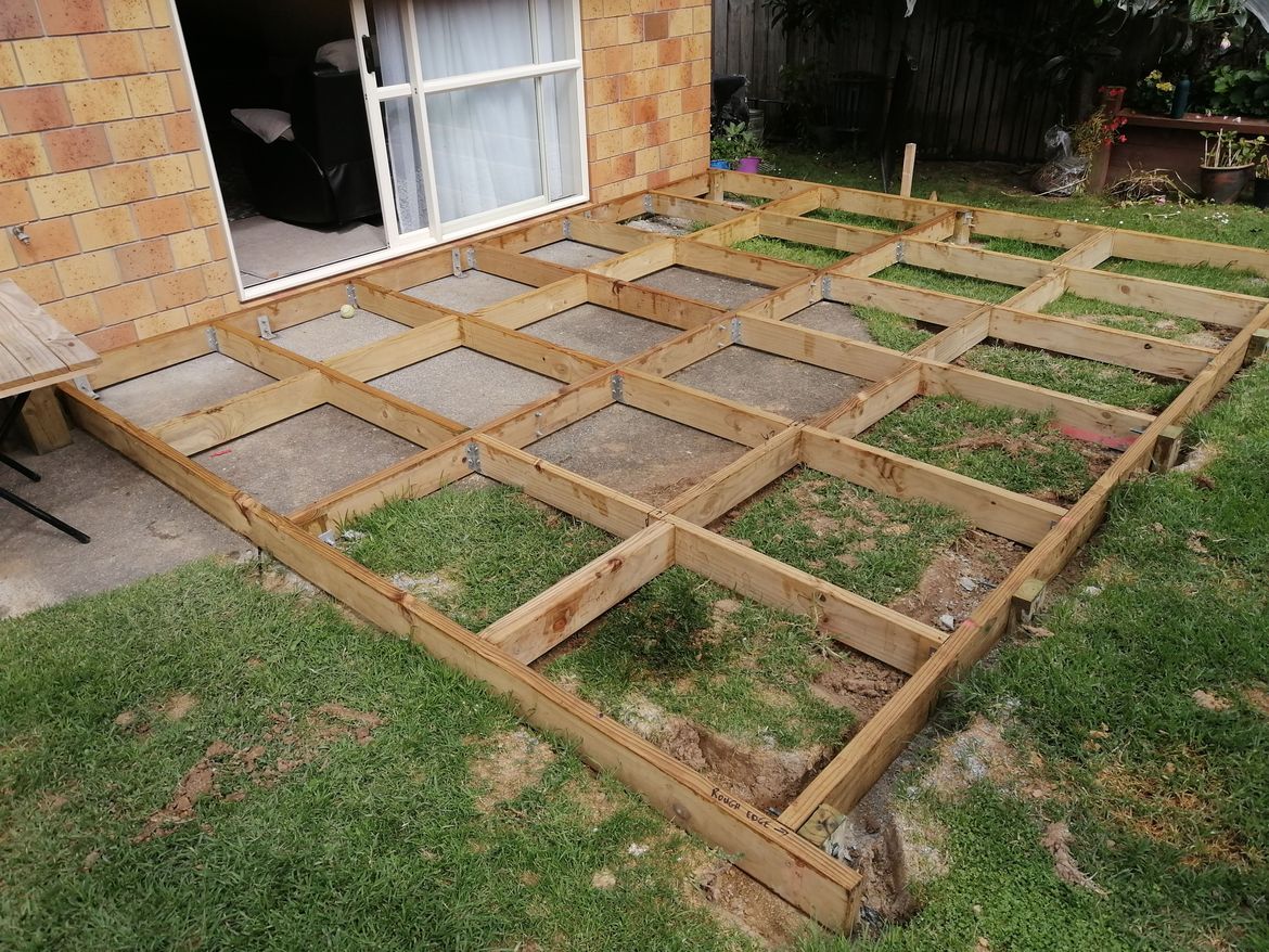

Marked out 3m x4m using batter boards to get diagonal length correct and square.
Step 2

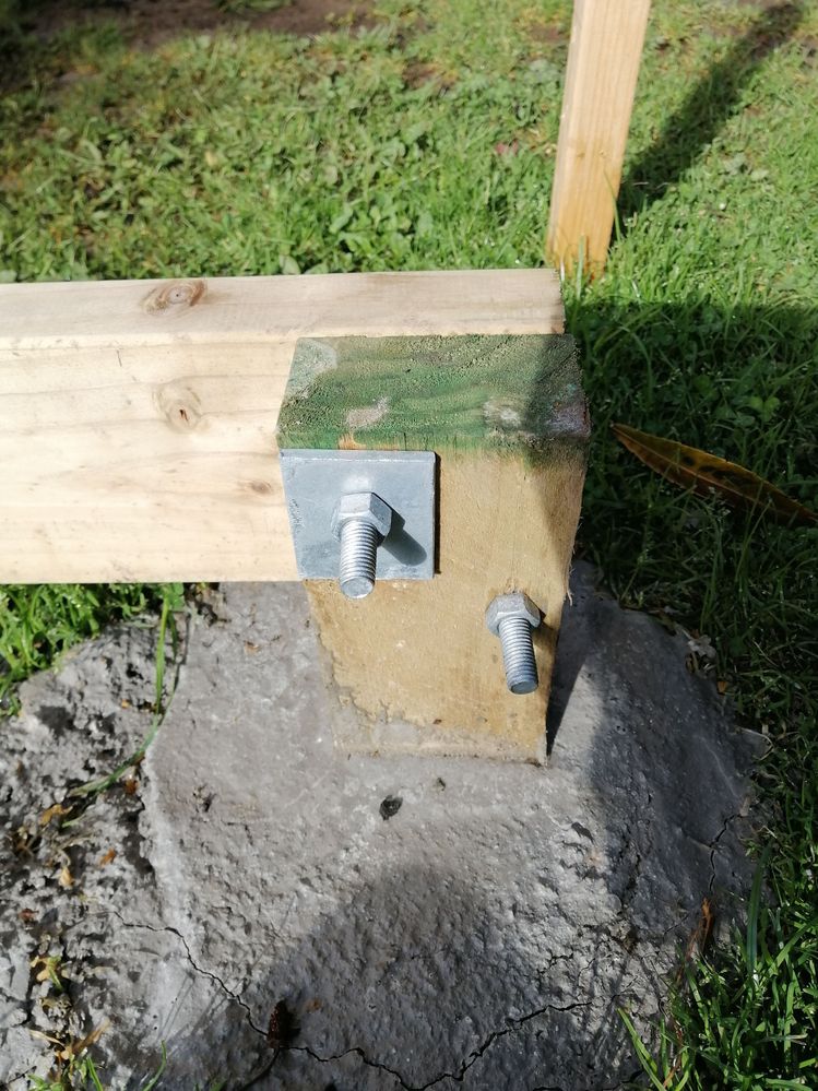

Marked and dug holes for poles
Concrete in poles
Step 3

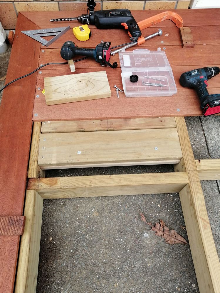

Installed joists and bearers
Installed solid square wooden base on four corners - this will be used to screw in the posts for the pergola that will be installed later. A solid base is necessary so secure the pergola pole - screwing the pole just into kwila is not strong enough.
Step 4

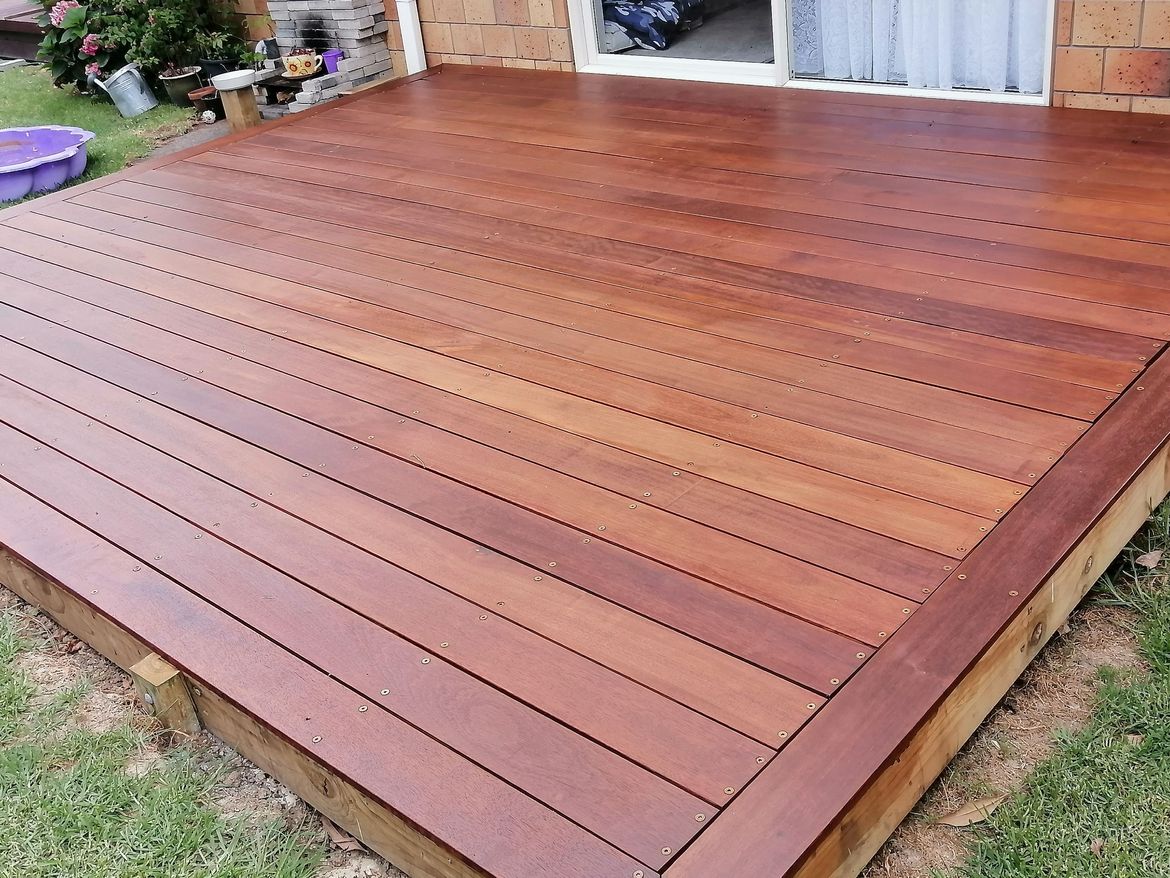

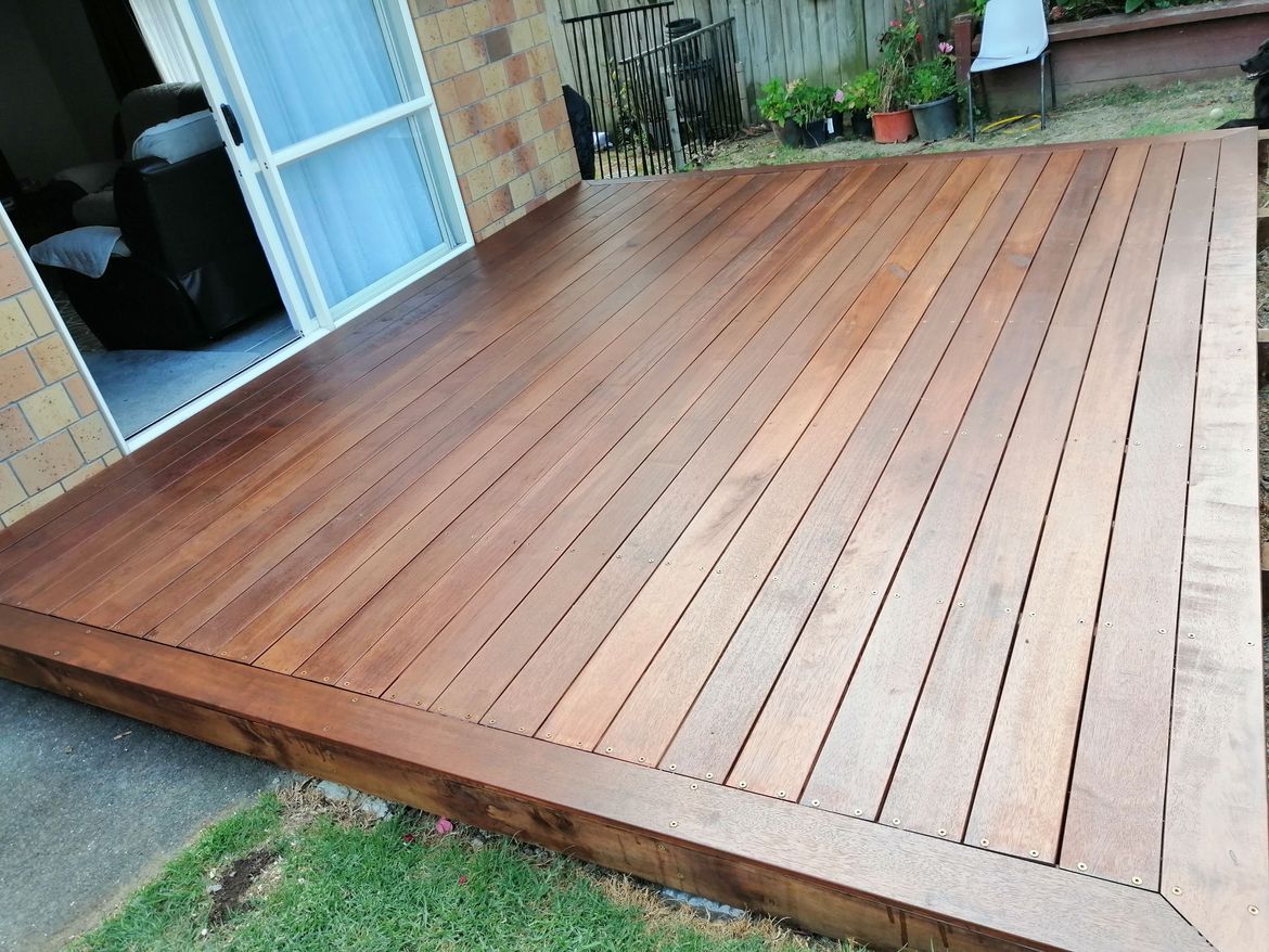

Used full length Kwila decking - no unnecessary cuts and joins
Installed Kwila decking with coach bolts - no nails
Oiled deck
