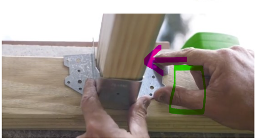

Re: Low level deck
Hi Mitchel/Eric
I must say you guys are very patient. One more question. When you say 'back slightly from the frame", would it be
1.  where the green square is shown i.e a little bit to the right of the joist hanger and so will still support the frame? or partly on top of the joist hanger?
2. or is it where the purple arrow is shown in the image below ( i am sure it won't be this option since in this case the post will not be supporting the frame at all)
A small pic will really help me. many thanks for your help.
p.s in any case the joists will be supported by the posts in the middle (i.e other than the ones attached to the frame) as shown in the image below
Re: Low level deck
Hi @jinugu
It is on the purple arrow and not on the green square. Support must be given to the joist as it carries all the weight. Depending on the type of post you are using, the example I've drawn up is with a 90 x 90 post. Have a look at the sketch and if you have any other questions, don't hesitate to post them.
