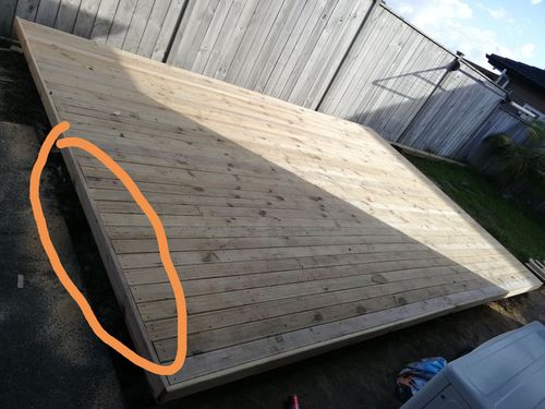

Hi Eric long time. I couldn't finish within the time frame I set for myself. But finally I managed to. I had to take the help of a handy man. Could have been better (in terms of finish), but still happy with the end result. Costed me atleast 25% less than what the cheapest builder quoted. Some quoted 4900$ + gst. Thank you so much.  Your comments based on the attached picture pls. What could have been done better. Do you recommend applying paint? If yes, your recommendations. Budget ones.
Thanks Ravi

Thank you so much for posting that photo of your deck. It looks very nice and all that's left to do is to either oil or paint the deck. Putting the finish on your deck is a very personal choice. I propose visiting your local store and looking at the beautiful sample deck finishes on display in the paint department.
Once you've made your choice, please make sure to get all the necessary equipment you'll need to either oil or paint your deck. It's important to follow the instructions on the paint can before you begin. Can you please tell us what kind of decking panel did you use for your deck? How long have you had the decking panel installed?
This extra information will help us to make more recommendations regarding the painting or oiling of your deck.

Thanks Eric. The decking board has been installed only 2 days ago.
Also, you would note that there is a gap as circled. Is it ok/recommended to leave it like that for air circulation.

Thank you for posting that information quickly. That gap under your deck is totally fine, it will provide a spot for air to pass through and it also serves as an exit for moisture. I suggest using Cabot's 1L Deck Clean before painting or oiling your deck.
If you have any other questions we can help with please let us know.
