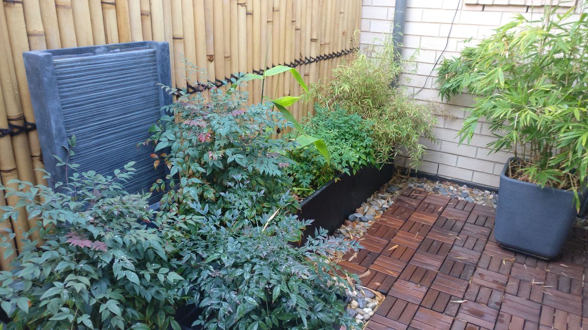

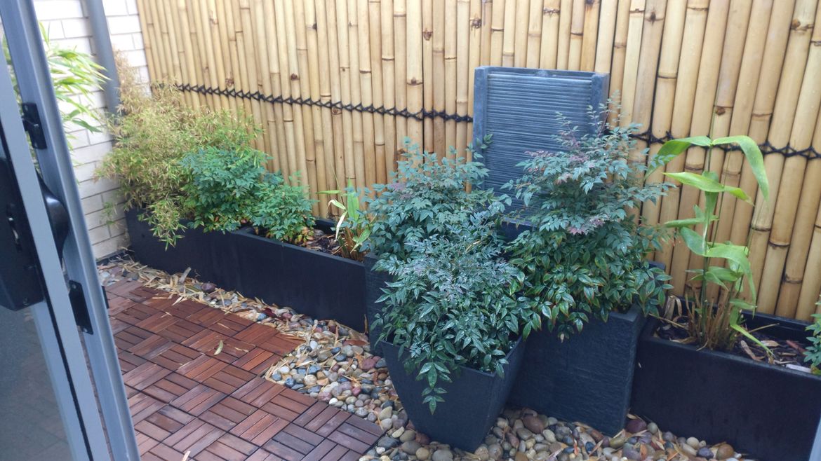

And in our internal courtyard, it had the same boring grey concrete pavers and grey colourbond fence so didnt look to good. Some bamboo panels, cheap ikea tiles and pebbles and some large square pots with a variety of plants (a few nandinas) and we created a Japanese style garden.
