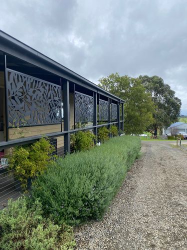

Here is the half day screening project we have just completed at my mothers for Mother’s Day using only Bunnings products.
We used:
•4 x Matrix Tangle pattern screens.
•4 x Aluminium black angle which was cut to size with a grinder.
•Black rivets to attach the screens to the aluminium angles.
•Black screws and angles brackets to attach the screens to the timber.
Hope this project inspires 😊 Let me know if you have an questions.

Welcome to the Bunnings Workshop community @hollyjj. It's fantastic to have you join us and many thanks for sharing your project.
Those Matrix screens look sensational and I love how you've used black angle to position them mid-posts. I'm sure your mother was very pleased with the results.

Great work @hollyjj, many thanks for sharing. I'm sure your work will inspire others.

Geez that looks fantastic !!! @hollyjj

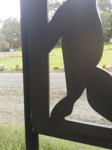

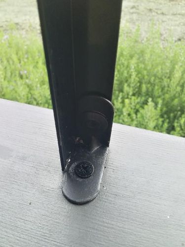

Unfortunately I don’t have any in progress photo but I’ll get some photos of how they have been attached 😊

There are a total of 4 rivets each side of the screens which were predrilled. Also there are two screws at the top of each angle (predrilled) to attach to the timber.

That's a very neat installation, @hollyjj. Many thanks for sharing the additional images and detail.
