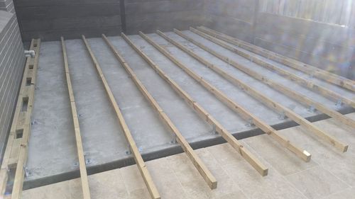

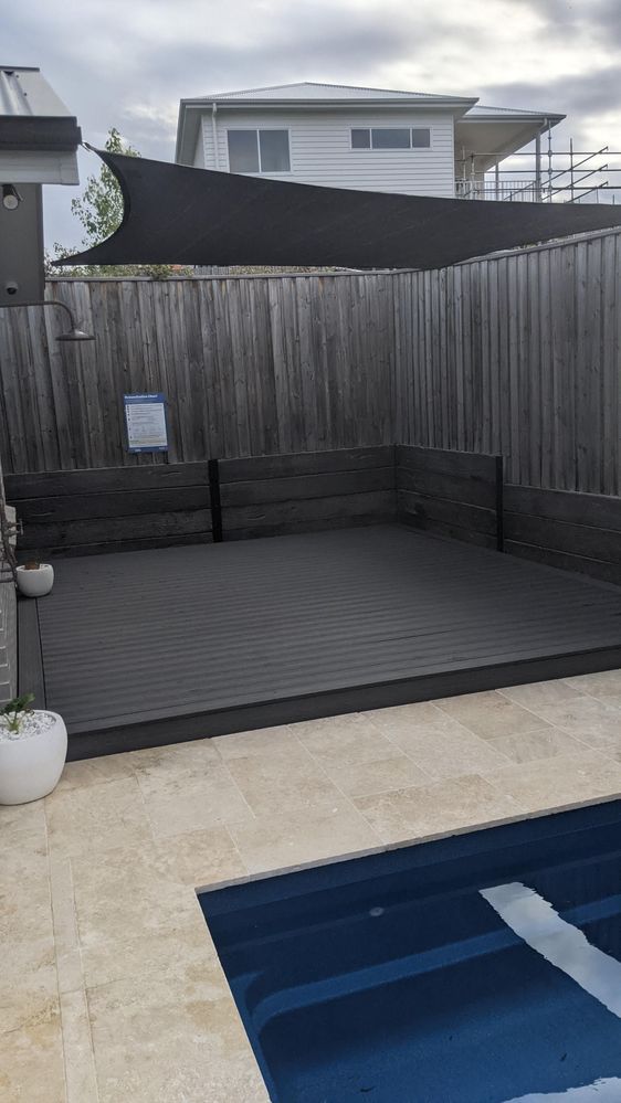

So I took some inspiration and tips from this post and started my deck today. I'll post all the products I used soon. Needed to stay as low as possible so used 70mm joists. Finished the frame today and the ekodeck goes on tomorrow. Thanks to everyone who contributed to this post, gave me the confidence to take this project on myself. I'll post photos of the finished product tomorrow.

Absolutely amazing work digesting the information and constructing an ideal frame! I love what you've done there. Those double angle brackets on the end of the joists are a novel idea too. Was that just for rigidity for the counter-levered section? Great thinking of having the bolt run right through the timber connecting the two brackets. I'll have to pinch that idea in the future. Depending on the height of the counter-levered section above the tiles, if you can manage to clad the frame ends in with a board that doesn't physically touch the tiles, you might achieve an awe-inspiring floating look to the deck. That would look brilliant.

woild love to see your final result..
also , would you mind sharing the link for the joist you used.! Thank you
@asb924 Looks really great.!!
would you have a link to all the other products you used?
also how did you finish your edges?

Let me tag @asb924 so that they are made aware of your questions. Just to help you with the deck materials, they used Treated Pine Outdoor Timber Framing 70 x 35mm for the frame. It was mounted to the cement floor using Galvanized Angle Brackets. The bracket size will depend on the height that you want your frame at. To attach the bracket to the cement floor you can use DynaBolts. To join the timber frame to the bracket you'll need to use Zenith Hot Dipped Galvanised Hex Head Bolt And Nut in combination with Zenith Hot Dipped Galvanised Washer. The size for these pieces will be based on the size of the angle bracket and the thickness of the timber.
Looking at the photo that was posted, I don't see any mounting screws in front of the side panel. This look can be achieved by using Ekodeck concealed fixings. If you are building a similar decking project, please keep us updated. Any photos you can post while building it would be much appreciated.

Nailed it @EricL thanks for that, was everything I used.
What is that green and black color on your joist shown in picture? Also did you go with 140mm board or 90mm board. I have 120mm ground clearance as well.

1- How much is the distance between the last two joists and specific reason to keep some clearance from the left wall?
2- How did you mount blocks between joists as some of them are not screwed
3- No bearers are used here. Any specific reason?

The last 2 joists are 70mm (the size of the joists turned on their side) apart because I did a picture frame/border and this worked. I also wanted to keep about a 45mm gap from the wall for drainage etc. I could have bolted one side to the house brick but I couldn't do that on the retaining wall side so did both the same.
The blocks were all screwed. I did the joists close to the walls first and then screwed the blocks in and then after the second joist went in I screwed them from that side, they were all to support the border.
I didn't do bearers as I needed the deck as low as possible, so height was an issue. I spaced the joists accordingly and probably over did it on the number of brackets per joist but did extra to be safe.
Let me know if you have more questions, good luck.
