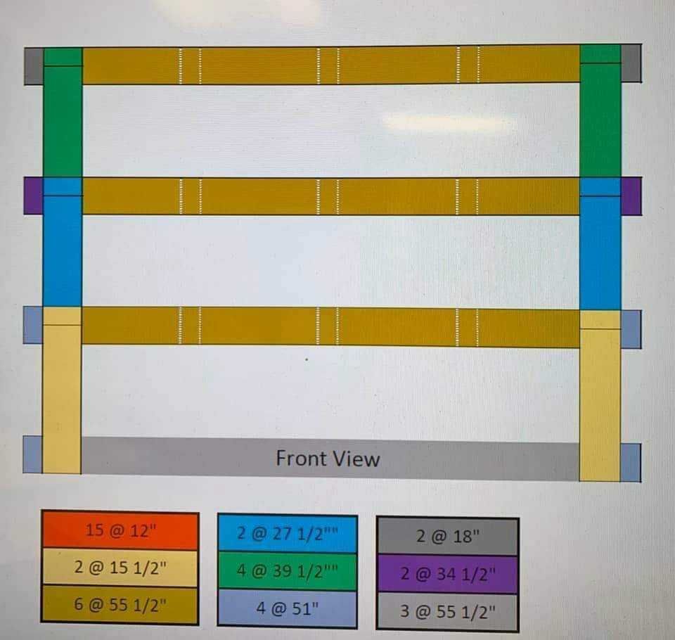

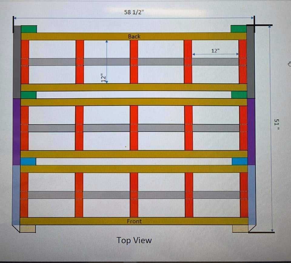

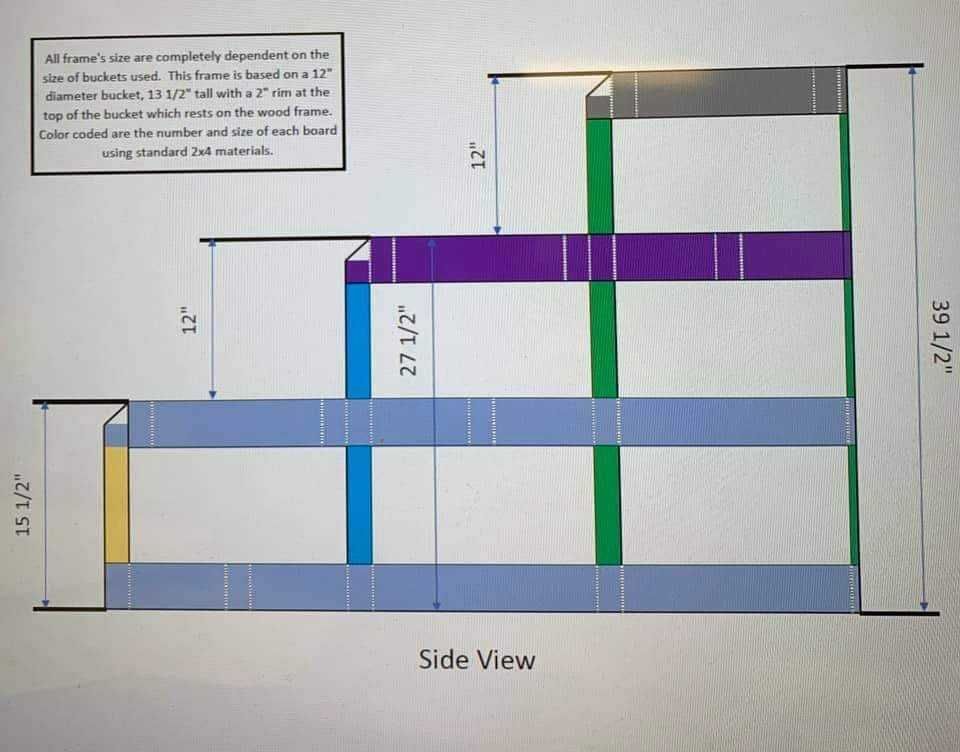

Sorry, I had no been able to get on for some reason and finally been corrected.429473550_935282441661548_3939112737211211809_n.jpg430063714_726802612990134_2392945198356707377_n.jpg431186471_969346634617969_5666033252366379993_n.jpg
KTW
Growing in Experience
Re: No digging or bending vegetable garden stand
This was the base design, I did change a lot as I added more in front and then at the back so I could add shadecloth for when it gets too hot and also to put some hanging planters with flowers to attract the bees.
