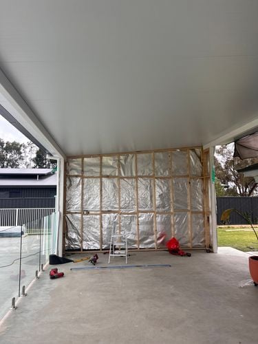

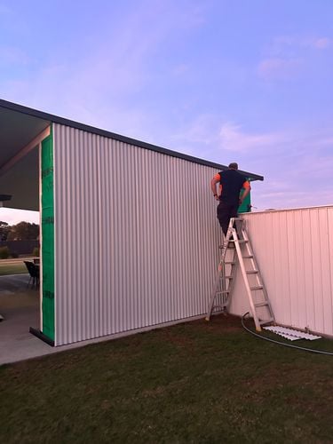

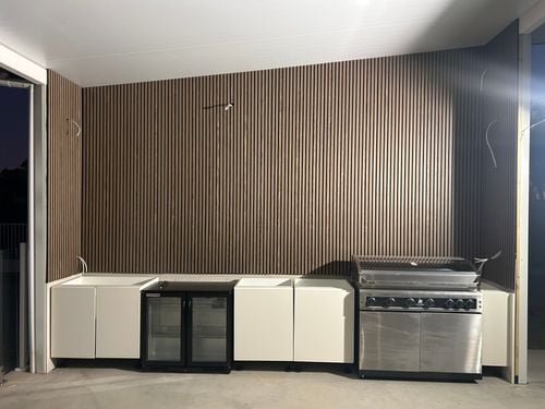

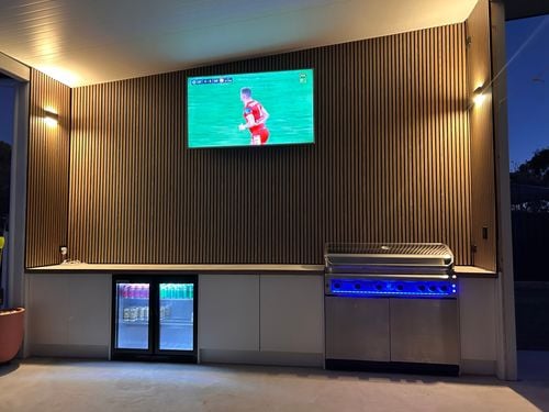

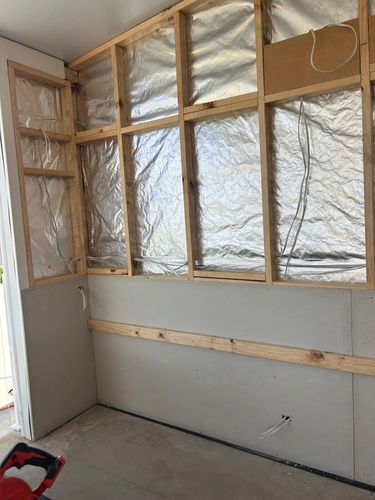

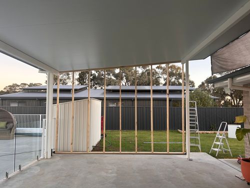

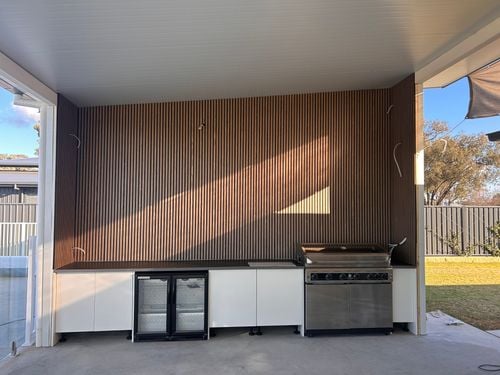

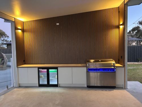

We transformed an empty outdoor space into a stunning DIY alfresco kitchen using Bunnings Kaboodle cabinetry and Prempanel timber-look wall panels. The design includes a built-in bar fridge, sleek DIY tiled benchtop, and stainless steel BBQ, perfect for entertaining. Warm feature lighting and vertical timber slats create a modern, cozy atmosphere. This project was a hands-on challenge but incredibly rewarding — we now have the ultimate outdoor area to relax with family and friends, thanks to Bunnings!
Steps
Step 1
Build wall frame
Step 2
Add wall wrap
Step 3
 Colourbond sheeting
Step 4

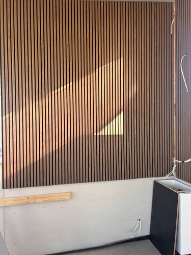

Run electrical wiring before cement sheeting the wall
Step 5
Attach Prempanel
Step 6
Build Kaboodle cabinets and attach to wall ace
Step 7
Glue and screw 2x marine ply panels together to make benchtop. This was then then tiled and grouted.
Step 8
Electrical fit off done by electrician
Step 9
Mounted TV on wall

Hi @meganp83,
This is an absolutely stunning outdoor kitchen. The vertical batten panels look fantastic with the feature lighting.
This looks like a fantastic place for a BBQ and to watch the footy on a Friday night. I'm sure it will play a part in many wonderful times spent with family and friends.
Thank you for sharing and congratulations on a job well done.
