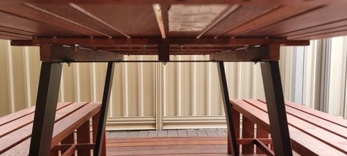

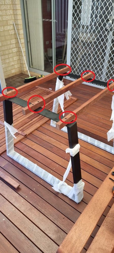

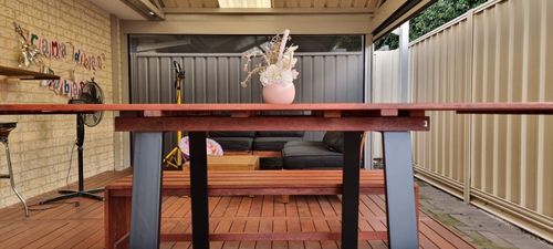

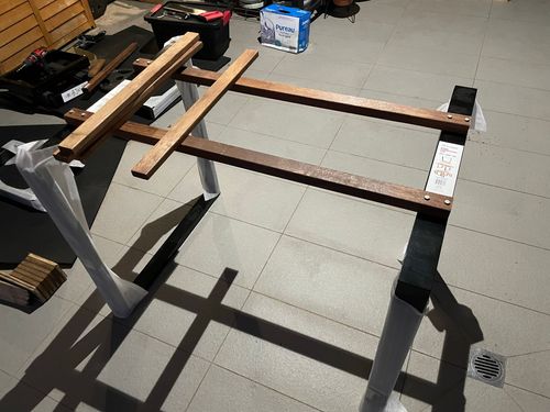

I added bearers on top of leg table to line up with the table leg hole 3x 2 holes per leg.
It added approximately 40 mm of total table height but still maintain a reasonable height when sitting on the bench.
Completed by placing the Merbau Panel on top of bearers and secured it with bolt and nuts.

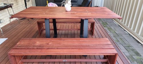

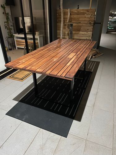

Placed in the deck with 2x Mimosa Merbau Bench .

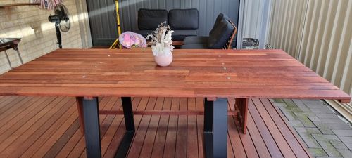

Hi @minklet,
I've used this same panel for an undercover fence (installed almost three years ago) and a pool pump cover that's seen several months out in the weather. Panelling undercover looks as good as the day it was installed, and the pool pump cover looks great too. I'd expect your maintenance to be similar to a deck; yearly oiling is all that is required.
The panels are quite robust and well-made, so there might not be any preventative measures needed to stop bowing/warping. Adding additional timber underneath that spans the length of the panel should prevent any issues. Four 42 x 28mm 2.7m FJ Pre Oiled Merbau Screening run down the length of the panel would certainly increase the rigidity.
Great! Thanks Mitchell
Thank you for contacting and tagging myself.
Yes, it has been a while since I built this.
At this stage this table seems to be good, no bending found in table surface or any underneath support-frames. I will keep observing until this winter season finished. Current utilization and load for this table: low to medium.
FYI, I am living in Perth WA suburb for your weather reference.
Happy to provide more picture for this table condition. Please allow me 2-3 days ( Away from home now)
regards,
Daniel
Fantastic thanks Daniel. Will definitely be building this

Materials
| Item | Quantity | Note |
| Merbau Fence Panel | 1x | Used for table top |
| 42 x 28mm 2.7m FJ Pre Oiled Merbau Screening | 1x | Used for bearer |
| 42 x 18mm 2.7m FJ Pre Oiled Merbau Screening | 1x | Used for joist |
| Table Leg | 1x pair | Due to unavailability at Bunnings stores in my area, I sourced my table leg from other vendor. However, these items may be available in your local Bunnings |
| Assorted Nut and bolts |
Note : 2x Benches are NOT DIY. I purchased it from bunning and assembly those at home. Luckily the color is match with my table.
Tools
Steps

Pictures below taken just recently (August 2023).
Hi @minklet,
I just posted some pictures for current condition of this table. I also add detail of materials and steps.
please refer to the post below.

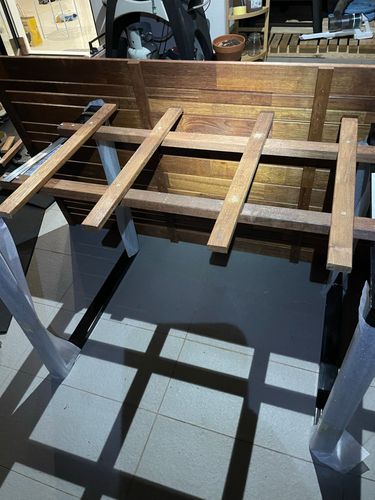

So I made the table, the differences being that I could not find any legs that had 6 bolt holes and instead got ones that had 4. I lengthened the main bearers to 1m (from 90cm). I used m10 bolts (the size that fits through), and used the same idea for cross pieces. It looks fantastic, however it is very wobbly. Not so wobbly its unusable, but it wobbles for a long time.
I think the problem is that the main bearers cannot be tightened enough to be rigid. Tightening them just digs the bolt deeper into the wood. Any ideas for better bracing? I just realised that I am using the bearers on the thinner side, perhaps flipping them would give more purchase
My initial idea was to get longer bearers and drop them to below the tops of the legs, so it's extending out. Then put bolts through the table top to the bearers at so there's more bracing. Not sure if this will provide much support.
Any tips for this? I'm curious how these legs are usually secured if it's not in this way
