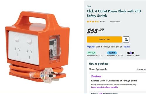

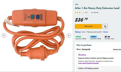

Hi @Ericlim,
I strongly recommend also purchasing this extra item.
Or this item.
The 1st one is ideal for your application and that is what I recommend.
The 2nd one is ideal for DIY out in the yard and both have RCD protection.

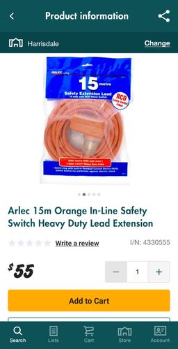

Hi AlanM52
Thanks for your suggestion. Just 1 query
1. Instead of the 1.8m arlec, epyld the arlec 15m (see attachment)
would this do so that I do not need to buy the other recommendation in earlier response? I needed a longer extension than 1.8m
