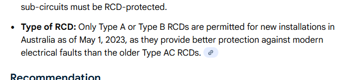

G'day @AlanM52
I tried AI this morning. Told me this...
Would all the Arlec products above satisfy this new Type A/B standard?
All of mine would be outta date - but I can't find Type AC written on any of them?
I can see AD.

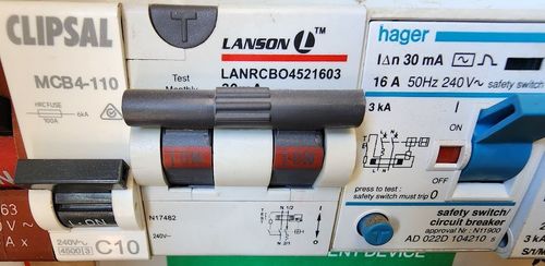

How ya goin @Noyade,
To me that looks like a very trendy 'up market' switchboard, checkout my photos!
Two story family home was built in 1971 by A V Jennings and the board has had one upgrade when the smart meter was installed.
