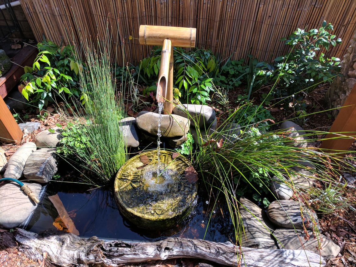

This is great, Alan. I like the way you have stabilised the spout with the cross-brace. You've got me motivated to get new water feature in place.
In a previous home, I set up a commercial bamboo spout with a solar pump and that worked really well too.
 https://www.bunnings.com.au/aquapro-1200mm-rectangular-feature-poly-pond_p2813392 and https://www.bunnings.com.au/aquapro-ap960sp-solar-pump-and-panel-kit_p2920263
I also had a bit of tricky adjustment of water flow to get the water to fall where I wanted it.
Plants grew really well though and it became overgrown in 12m, and pump got clogged, so maintenance need.
Don't lose the instructions for dismantling the pump and changing filter!CH pond.jpged.
When I sold the property, I wanted to pull out the pump and take with me but REA said leave it and sure enough, new owners filled in the pond :(.
