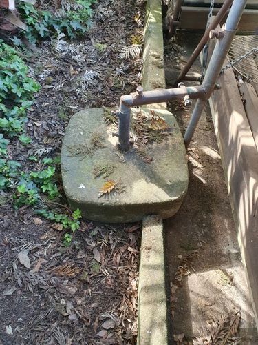

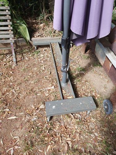

Two more suggestion then. I wholeheartedly recommend Mitchell's suggestion of utilising wheels. One of my first base creations was concrete. I used a hot water sheet metal frame as the basis of the shape to hold the rather complicated articulated arm that supports the umbrella. Holds steady in a hurricane - but I can no longer lift or move it.
A better design was with steel - and wheels.
