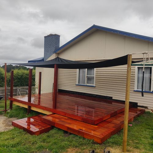

 been a long road but this is where I'm up to.
Decided not to do the cantilever after talking it over with a builder friend. The posts come through the deck surface and will form the fence around the tall side of the deck.
Re: What spans and cantilever for deck?
Hi @scotth,
That deck looks brilliant!
I love that you've incorporated the three tiers to tie it in with the slope of the land and give you a really nice transition.
I'd say it was a wise decision to go without the cantilever, and I'm sure you have a much sturdier deck having done so.
Thank you for sharing. I hope you are happy with what you've achieved so far. I look forward to the next update when the fencing goes in.
