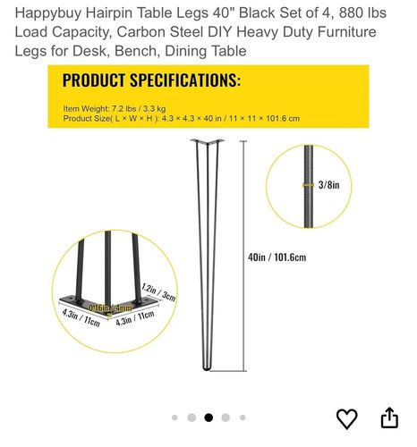

We have hairpin table legs we are planning to screw on - similar to the image attached. Our balcony is covered and we can cover the table with tarpe/waterproof cover to help. It is only for a rental so if it lasts 1-2 years this is great.

Thank you for your help. I purchased the wood, sandpaper and varnish you suggested. Unfortunately the screws that came with the hairpin legs are too long for the depth of the 285x19x1.8 DAR pine.
Could you please let me know if there is another screw size I can buy for Bunnings to attach the table legs? I have attached the dimensions of the legs for reference - the holes are 6mm. If so, what drill bit size would I need to pre-drill holes for the new screws?
Thank you!
Hello @egb_00
I suggest bringing the table leg with you to the store and testing the following:
These screws are short and have very sharp tips so will not require pilot holes. My best advice is to not to overtighten the screws to prevent stripping the screw holes. Once you have confirmed that either the 6G or 8G fits you'll know which screw to get.
