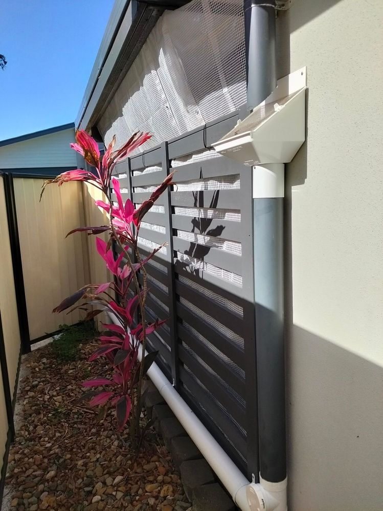

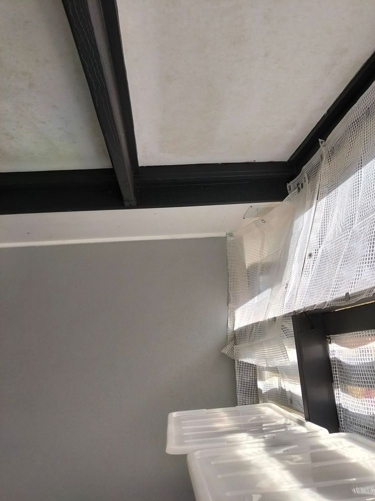

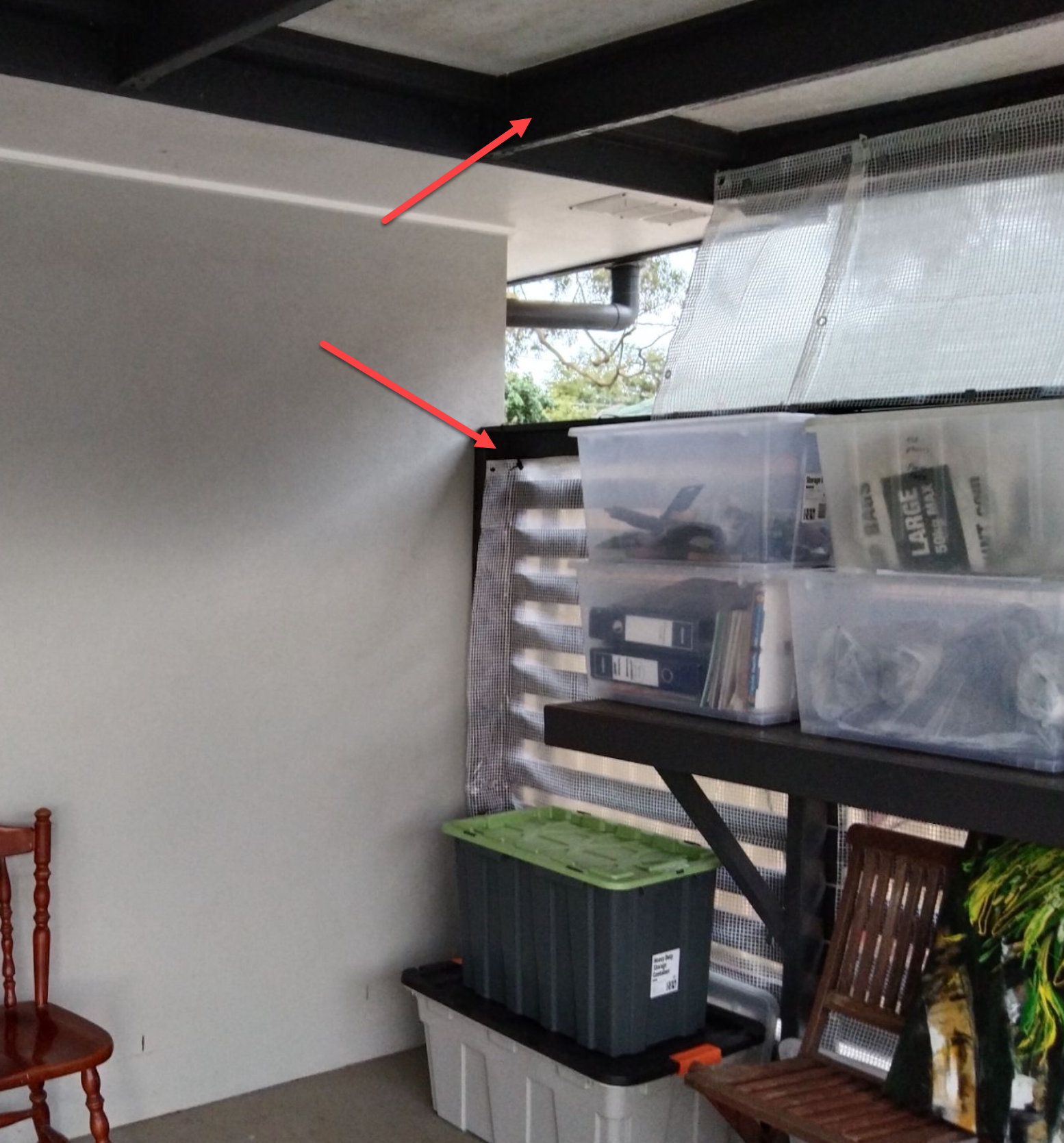

Thank you Jacob. No, they're not aligned (trick of perspective - see photo).
I think the link I provided wasn't the right choice.
Maybe it should be 3M of  this one cut in thirds (to fit in my small car). I'd then need to attach the 3 pieces together.
https://www.bunnings.com.au/suntuf-10mm-x-3-0m-clear-sunlite-twinwall-polycarbonate-roofing_p1010590
It's the top section that will be tricky as there's nothing there to attach to. And it's the most important section as this is where all the rain comes in.
Perhaps the only solution is to reinforce the existing clear tarp with some extra pieces, as there seems to be nowhere for the polycarbonate to attach to at the top where it's needed. The clear tarp is attached with shade cloth timber studs.

Essentially, you need to create a solid edge for fixing the polycarbonate sheets. The soffit in that area isn’t structural, so you can’t rely on it to hold the sheets securely. What you want to do is attach something like a 42x42mm timber up into the structural timbers behind the soffit. These timbers usually run along the edge, often spaced every 450–600 millimetres. Once you’ve located the timber behind the soffit, you can screw the timber into it, creating a strong fixing point for the polycarbonate.
Even a few well-placed brackets could work if that’s easier, but the key is to find solid material behind the soffit that lines up with where you want the sheet to sit. That way, the top section of the panel will have a proper support edge, which is especially important since that’s where all the rain comes in.
