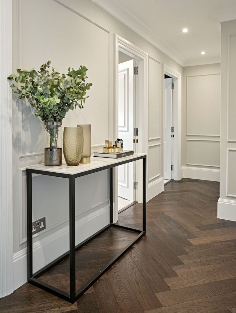

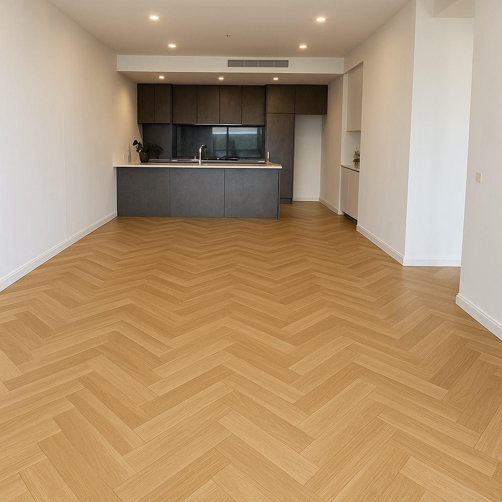

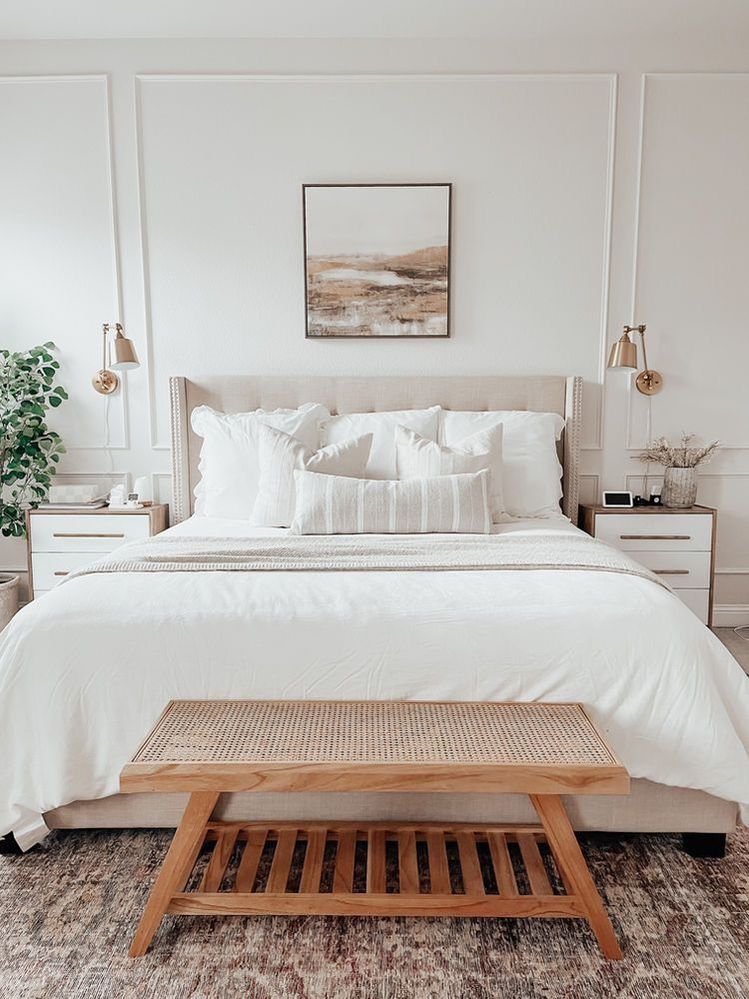

I’ve attached a photo of the actual living room and two inspiration images for context.

There are quite a number of timber mouldings available at the store and each of them come in their own unique profile. For example, the Porta 30x12mm 2.4m Panel Mould Clear Pine and the 15 x 11mm 2.4m Clear Pine Insert Mould are very similar to the sample image you've shown. But size and style are critical, and I therefore encourage you to come visit the store and look at the timber mouldings to give you a better idea of how they will present themselves when attached to your wall.
