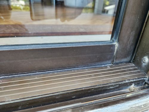

Thanks for the feedback. So the only weep holes are in the door track and under the fixed window pains on either side.  The flyscreen track is installed in front of these weep holes and there are no weep holes in the flyscreen track therefore all the weep holes are blocked. Ive attached some photos.
Bit hard to see but this shows the weep hole on the inside.

Hello @gmlittle_01
Thank you for sharing those photos of your door tracks. Can I please ask you to post a photo of the entire track so that we can see how your window is arranged. Please make sure that we can see the channels as it will give us a better idea which tracks are fully occupied and which weep holes are blocked. We can then make suggestions where you can place new weep holes for the tracks.
