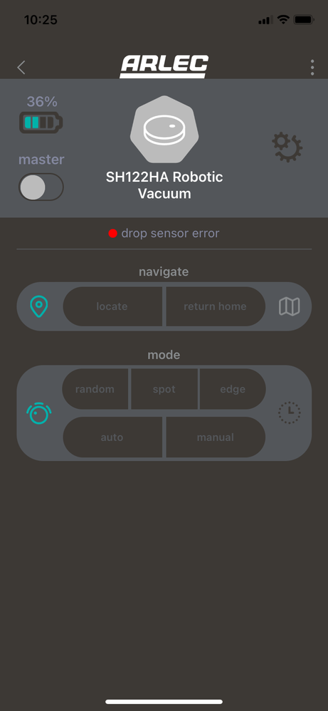

When the unit stops in the middle of the floor does it emit any sounds or does the green light stay on permanently or flashes in a slow sequence? To eliminate the possibility of sensor error, I suggest giving your robot a thorough clean. Please refer to your owner's manual page 15.
Remove the rotary brushes and take off any hair or lint that might have gotten stuck to it. Clean the main filter and use an old toothbrush to brush away any imbedded dirt. Remove the main brush and remove any tangled hair and debris stuck on it. Most importantly make sure to clean the sensors around the wheel of the unit. Give it a full wipe down making sure that it is free of dust. Charge the unit to full and test the unit again.
If after cleaning and charging the unit and it still stops in the middle of the room, I suggest having a look at the remote and see if the unit has been accidentally set on a timer or the cleaning mode has been engaged. If they have, I suggest turning them off or setting them to default.
