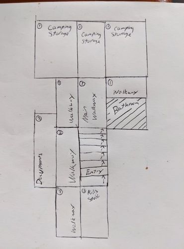

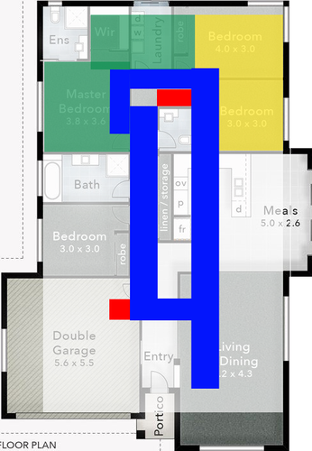

The goal is simple, create a working Attic space where we can store items that we don't use often (such as camping gear) so that our primary storage always has a use. This is the primary area we came up with and what will be stored there.
(Note: Number 1 indicates the storage we are building now, Number 2 indicates the first expansion).
The completed version will end up looking like this:
Red: Access Ports
Yellow: The first Storage Area
Green: The Second Storage Area
Blue: The Walkway
Why a walkway? One of the most annoying things I've done in any house is setting up stuff through the roof, having to carefully walk on beams gets old after a while, so the Blue Walkway is for us if we ever wanted to create additional storage areas, to connect our two access ports (the original one in the house is in our garage) and for trades to be able to access and walk through our roof much easier when they are here.

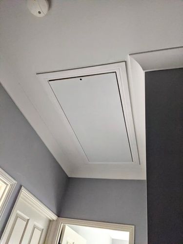

FIRST STEP - LADDER

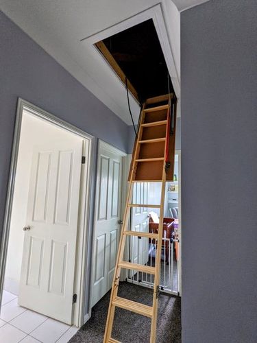

First up is the ladder, we didn't do anything too special with this, Bunnings do a really good Attic ladder Install video that you can follow to get an idea of how to do it, my dad has put hundreds of these things in so it was a 1 hour job for him. We placed it here to be out of sight, as we didn't want it to be noticeable down our long hallway.

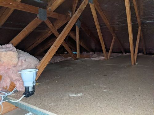

SECOND STEP - ATTIC

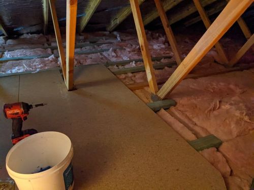

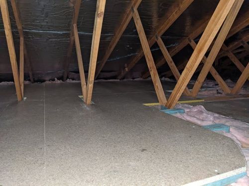

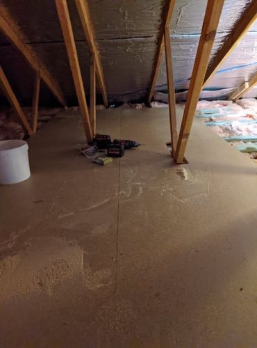

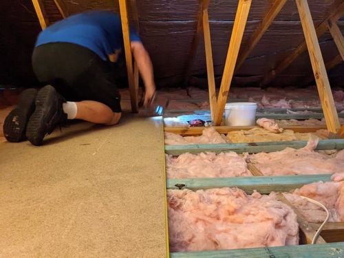

The next step is the Attic, we used various lengths of Blue Pine that were installed in the opposite direction to create a bit of a gap between ceiling timbers (allowing for cables to run underneath) and so the attic itself was more stable. Once these were in the places we wanted, we measured the sections and cut our Flooring Particleboard Yellow Tongue to size. As soon as the first bit is down and secured, the rest of the build is a breeze.
After about 3 hours of cutting, moving and installing, our first storage area was done.
Again, this is the hardest part. With this completed (stage 1), I can now complete the rest of this project in stages, so every Bunnings trip I grab a length of blue pine and some yellow tongue, cut to size and just place it down according to our diagram. In time, it'll be complete, but as our focus was the first storage area, it's not a priority to do in one day.

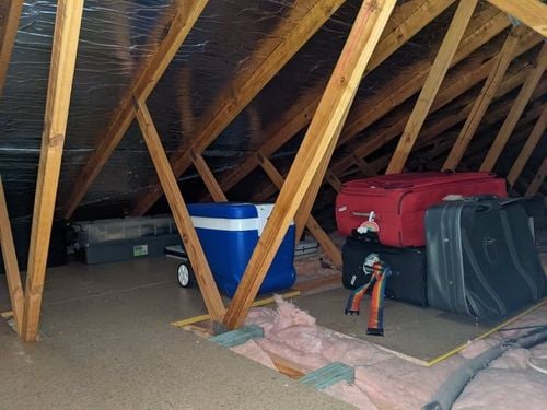

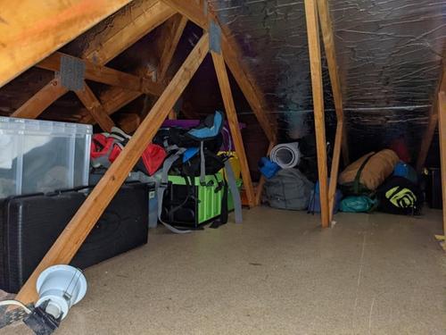

The first storage area ending up being more than what we needed, as we thought we had more stuff than we actually had, but I've been expanding since these photos regardless. I bought a wireless lighting system from Ikea that is used for lighting up here and will expand it along the house as we go.
An extra benefit from this project has been a noticeable decrease in temperature below the yellow tongue, with my baby room and 2nd bedroom a few degrees cooler than it has been previously, which is great.
