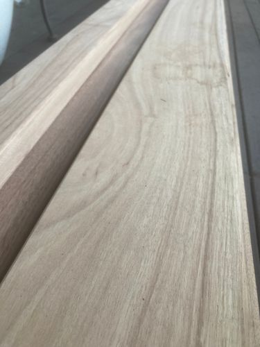

thank you for your advice, I'm going to get some external wood glue instead. Here are two photos, one of the Blackbutt hardwood (for you to admire

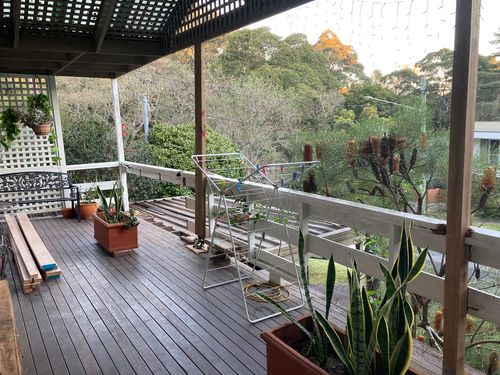

and a general view of the site.
I want the railing cap (140x35) and the upper rail (70x35) to meet at 90 degrees so they form an "L", this avoids them bending the same way over time.
Are you sure to use thicker dowels? I considered 19mm initially, but was concerned that when I hammer them into the upper rail's short side (35mm) I don't have enough material left and right.
Beautiful Blackbutt with pencil round edges.
A temporary sleeper replaces the rotten post.
I believe it should work, but your holes on the rail must be precise so that both sides have the same thickness. If you have some offcuts you can try to practice this part first to make sure everything will work.
