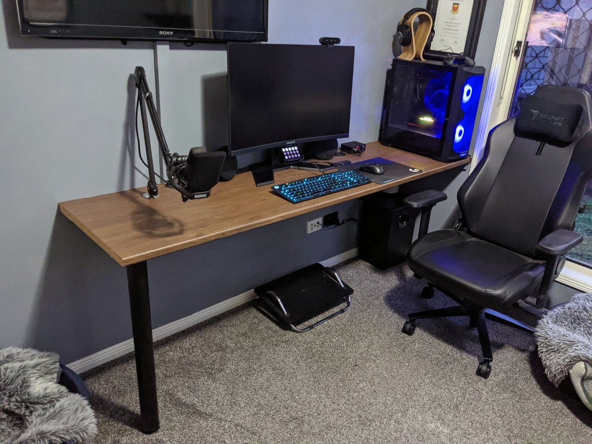

Continuing on from a previous post regarding our DIY home office drawers, this is the custom desk that I built for working at home & gaming. It is 2 meters long and 600mm deep, allowing for plenty of desk space. The desk itself is secured to the wall using 30mm pine and various  brackets, it's further supported by a taskmaster black steel table leg. Mounted on the wall is a 4k screen used as a secondary screen, the cables are hidden in a cable duct.

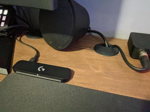

The desk features 5 holes, 3 are 60mm wide to accommodate the taskmaster 60mm Grommets, the next hole is 40mm wide and is used for the Microphone Arm. The final hole is 30mm wide and is hidden behind the desktop, which is where all the cables are fed through.

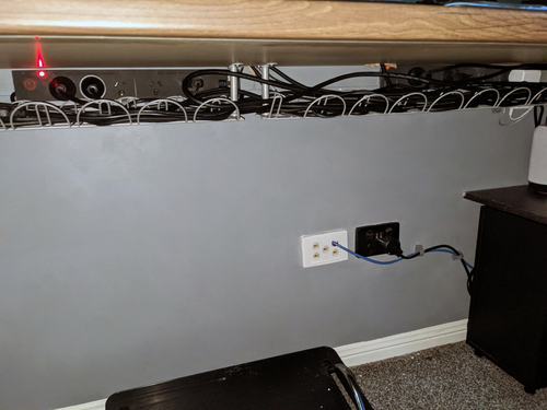

Mounted on the pine boards are 2 large power boards, these are fixed securely and have 0 wiggle to them. Just in front of that is the IKEA SIGNUM, an extremely popular cable management option (NOTE: Under desk cable management such as this is something lacking at Bunnings, it's something I really wish would be something purchasable at your local Bunnings). These are secured under the desk and hide a variety of the cables and taking away any of the loose, dangling weight.
The Ethernet cord isn't my best work, but purchasing from a homeowner who went a little crazy with some DIY renos, I had few options, this (along with the power cord for the power board) is secured to the wall via a cobra large cord clip and goes to the back of the desktop via a 40mm hole cut out above the subwoofer stand.

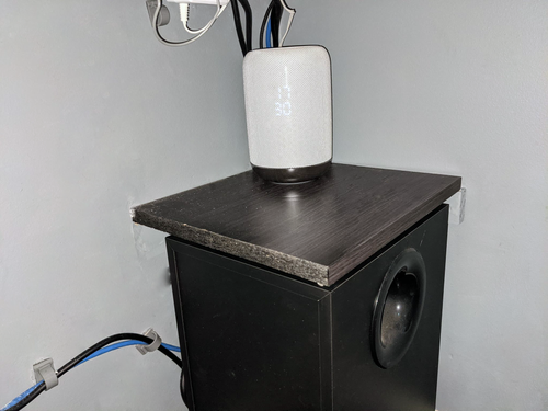

The stand itself is nothing too pretty, it's made out of some leftover board I used for another project and secured to the wall via pine and brackets. It covers the subwoofer well and acts as a shelf for our Google Home Unit.
