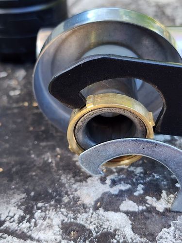

Evekare is a good product. The locking mechanism is great, but the spanner that comes with it is a little small and flimsy.

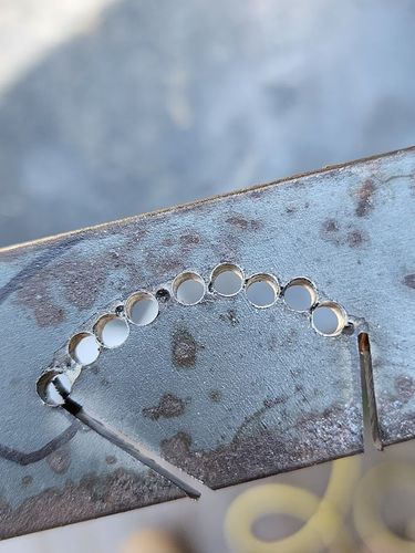

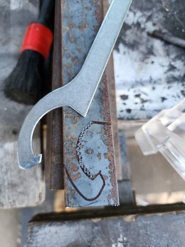

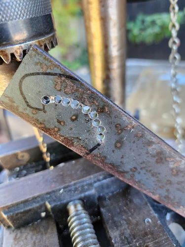

So I decided to make a replica with a little more muscle from 5mm plate.
Feels much better to use and I made it longer for more turning power.

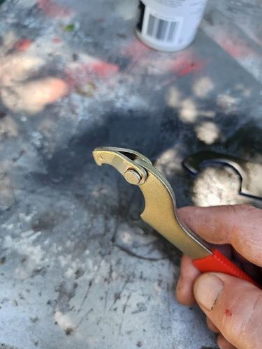

Interestingly the mechanism is similar to a bicycle collar remover.
I tried it - but the hinge is too bulky.
