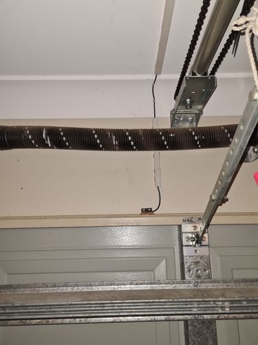

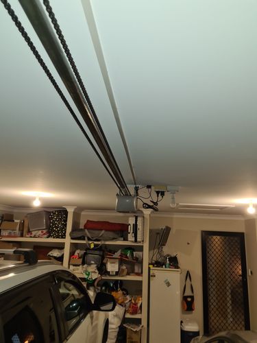

First off the Orion garage door opener is installed on my panel lift utilising the OSC terminals of the existing garage door motor. I used a length of Deta cable duct to encase the cable along the ceiling you can use double sided tape but I also like to use some dabs of no more gaps every 300mm.

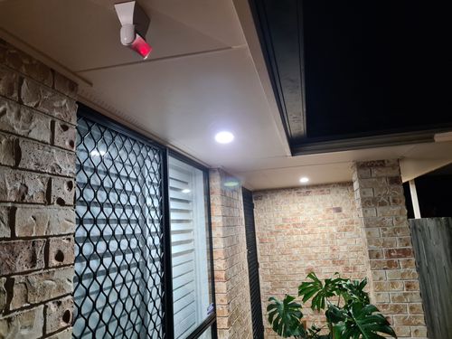

Second I installed 7 x Luce Bella 92mm LED downlights into the eves of the front of the house ( I relocated 6 as I installed 6 Arlec grid connect 92mm at the back)

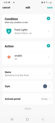

I connected these in parallel to the switch to the Deta grid connect PIR sensor and have set the lux to daytime so that it picks up movement during the day and night. Why? I have a automation  that sends me a message when the sensor turns ON that someone is out the front.
With the PIR in parallel it means I can use the switch without disruption to the sensor.

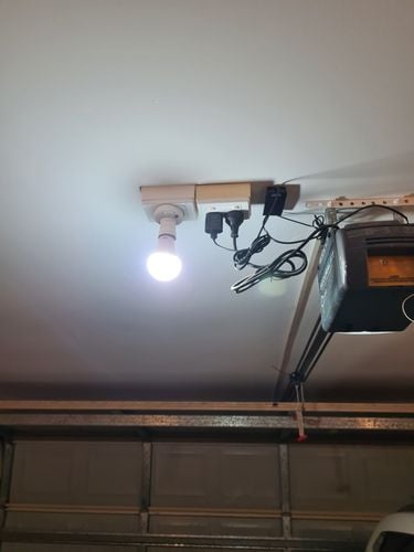

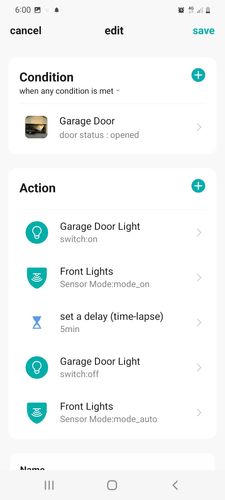

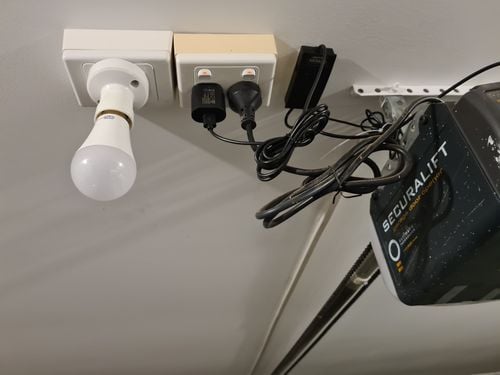

Thirdly if thats a word I wired a Batten holder next to the power point in the garage where the motor and orion control plugs into and have a BC grid connect globe connected here. This comes on for 5 min along with the outside lights when the garage door changes stays to Open and after 5 min turns off. Because the garage lights get used so much there is no guarantee they would be on at the switch and as I work split shift at The Big Green Shed I want good light when I come home.

Drive home.

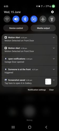

Around the corner hit Google on car stereo. Response is Can I Have Your Pin
Respond with pin, response garage door open
Alert. Garage door Open, Someone is out the front
7 downlights are on
1 x Grid connect light is on
Drive in
Press Google on stero say close Garage door, garage door closes
Lights outside and inside stay on for 5 min then turn off.

Someone walks out the front day or night.
7 x downlights come on
Alert comes through Someone is out the front.
Lights time out at 5 min.

Hey, I also have a Sectional door for the garage door it looks like you have the sensor glued to the wall
