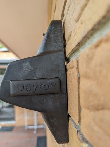

Hi, I tried to install a Daytek clothesline onto my brick wall using the Dynabolts suggested but even though I drilled 8mm holes for 8mm bolts the anchors are loose and are being pulled out by the weight of the clothesline.
My brother in law suggested using Ankabolts and they do look easier but the 8mm ones are too wide to fit through the mounting brackets. 6mm ones fit but are obviously too narrow for the drilled holes. Is there something I can use to make the 6mm bolts fit in 8mm holes?

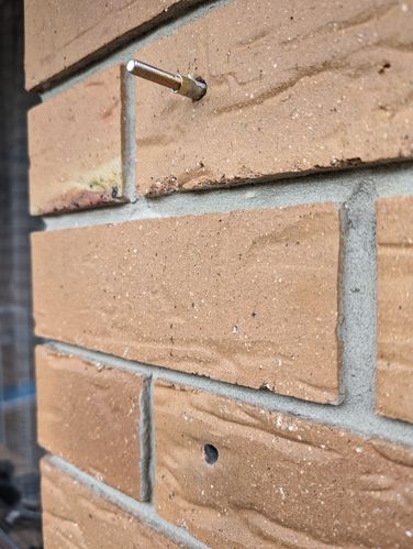

Hi, sorry it took me so long to reply. It took me a while to find the time to get the products and then to attempt the fix. I managed to remove the bottom two Dynabolts ok but the top two of each bracket are stuck. What should I do if I cannot find a way to remove them?

While holding the outer sleeve with pliers, tap the bolt section into the wall. This pushes the bolt section further in and disengages the locking mechanism. If you are able to tap the bolt further in while holding the sleeve in position, that should allow you to remove the outer sleeve and bolt. Alternatively, you might have to look at cutting the bolts off and moving positions.

Hammer and pliers did the job! Thanks
