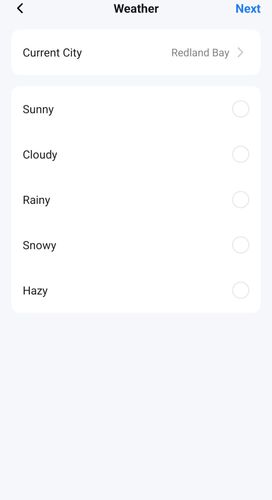

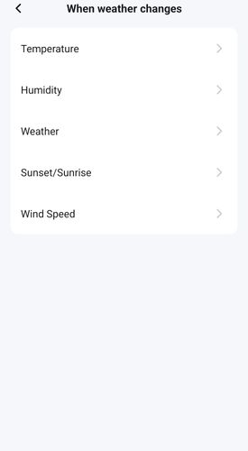

@EricL @sjb325224
I'm not sure what conditions there are in the Grid Connect App these days I have not used it for a while as I moved to Smart Life instead due to more functions.
Here is what you can do within Smart Live for Weather triggers

I’ve downloaded the app for Smart Life and it does look better, but suffers from the same core logic failures.  It allows the selection of “if raining” run task, but has no ability (from what I can see) to reverse the question and say “if not raining” run task or “if raining” do not run task or disable task if raining.
It does have the option to say “if sunny” or “if cloudy” run task, but this would not meet the criteria as it can be clouded with or without rain.
Its a pity, as they have included this logic with the ‘Wind’ option, where you can specify above or below a criteria for running a task

@sjb325224 would you not just create another automation for if Sunny then Action? That would meet the same requirements as If Not Rainy
So Automation 1 named If Rainy.
When condition changes to Rainy.
Action
Turn Light Bedroom On
Pre Conditions
All days All times
Make sure Location is set correctly.
Automation 2 named if Sunny
When condition changes to Sunny
Action
Turn Light Bedroom Off
Pre Conditions All Days All times
Make sure locations are set correctly.
Sometimes you need to split the Automation into 2 or more seperate Automation Tasks if you can't reverse it or don't have the option at all.
