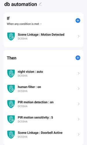

This is my 'automation' set up:

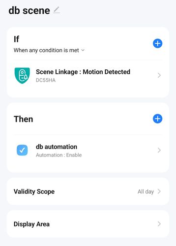

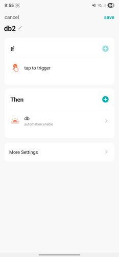

This is my 'scene' set up (although its only the 'tap to trigger' scene as it's the only option available, so might be redundant?):

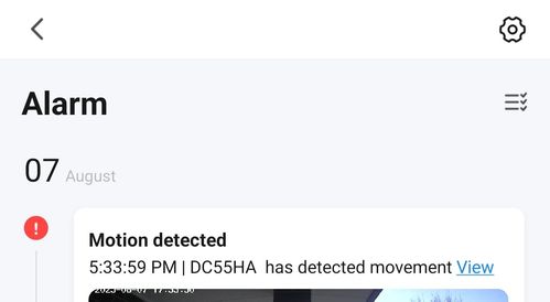

I get notifications that motion is detected, but playback doesn't record anything (assuming because there's no specific motion detect 'trigger' for it to do so):

I gave the above a go to no avail unfortunately, but I did download the SmartLife app and it is much more user friendly. The scenes and automations do look a bit more relevant as well. I set up both and it does seem to register in the scene logs and, notifications so it is doing half the job

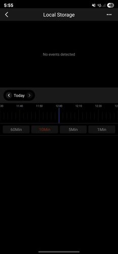

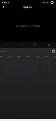

The playback however is still busted and doesn't record the activity throughout the day like it use to
I might keep tinkering for tonight and might somehow fluke fixing it. If not, I might give them a call tomorrow. Whatever the outcome I'll be sure to post for reference.

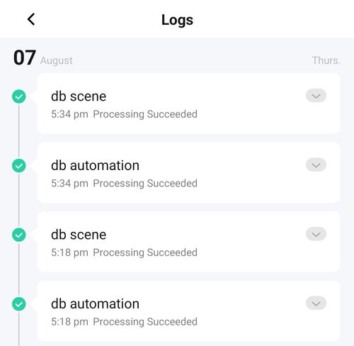

Automation set up on SmartLife:
Scene set up on SmartLife:

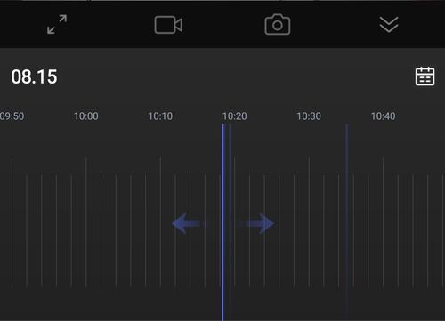

Problem all fixed it seems. I bought a new micro SD card and after the usual unpair, uninstall, reinstall, re-pair, I formatted the SD card and we now have my motion and activity recording on my playback:
Turns out after me focusing in on scenes and automations, I didn't actually need them in the end. As long as PIR is on, it will record on playback regardless, so looks like it was an SD card issue all along.
