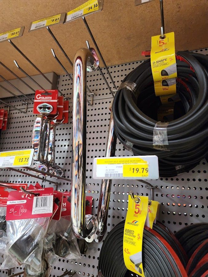

At Bunnings this morning.
I have used these handles on large steel doors.
But was wondering if they would suffice as a vertical hand hold for someone stepping up through a doorway?
Or should I be looking in the bathroom section - Aisle 64?
Cheers.

Assuming you are looking at the Goliath T25 x 335mm Stainless Steel Grab Handle, then as long as you mount them to the framing using suitably strong fixings, I can't see any issue using them as a vertical handhold.
Do you know what sort of framing you've got around the door?
I'd say a couple of 50mm timber screws should do the trick, assuming you have a timber-framed home.
Let me know what you think.
