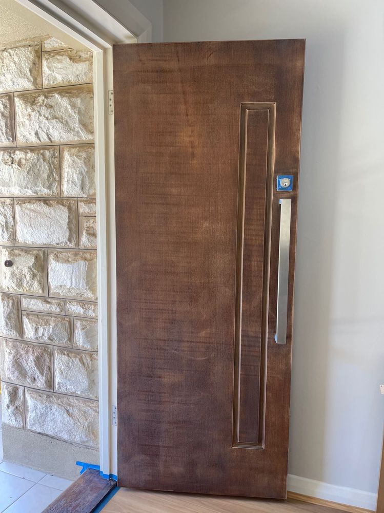

Recently we have  changed our Floor colour so we need to change our main 2 door colour . We decided some thing  neutral colour.
But our present door is like Varnish colour .
Could I please have some advice how to do that easily ?
Thank you in advance
Present door colourPresent door colourwould like to do similar colourwould like to do similar colour

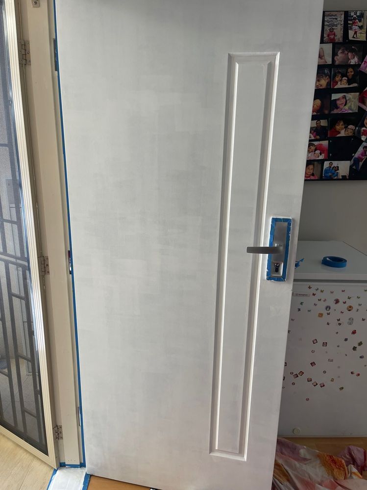

Here is some update After sandinfAfter sandinfafter Primingafter Priming

I really can not Thank you enough for your details advice on this project . I do not have much experience but with this community's  help I have started doing some small project .I took your full advice and tried to do all in one day .but I need little bit more time as I am doing 2 doors .
You know what I saved lots of money today with your advice . Thank you for so much for that .
Doors looking pretty good so far , just need to final coat . Hopefully I will finish tomorrow and they I will upload final photos .

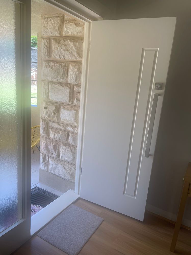

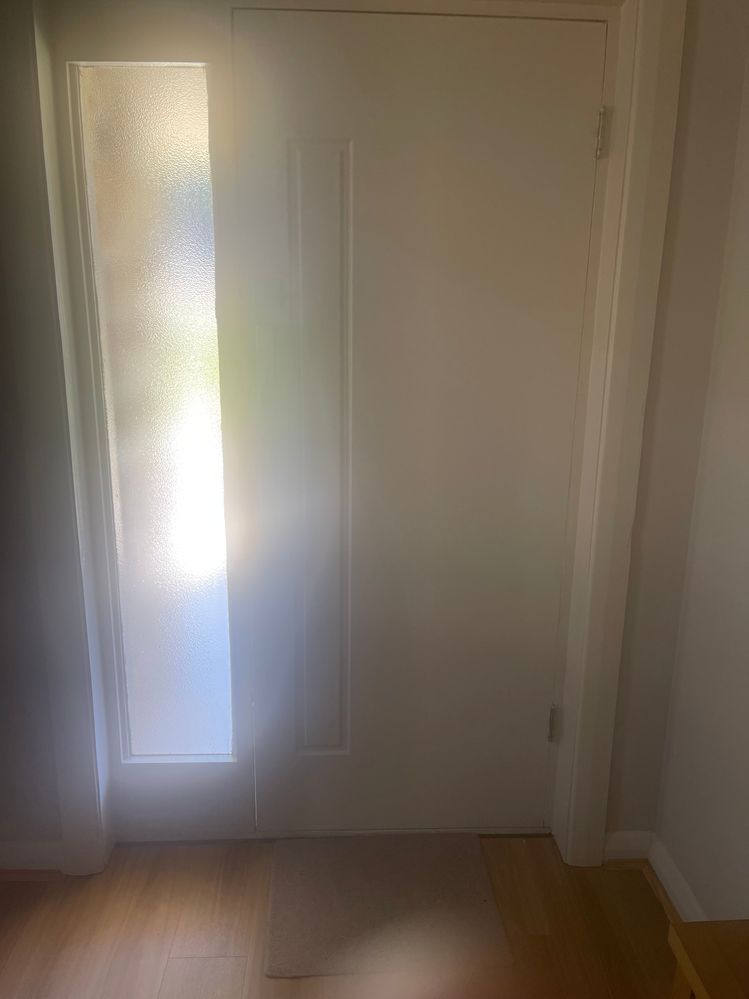

Hello Everyone
sorry for late upload.
Please find my final colour of the main door
Thank you so much for everyone for your support
Re: How can I change the door colour ?
Top  job @mmd22
it looks brand  spanking new :smile:
I like the long door handle to as I have longish curved one too.
And out the door really nice stone fascia  matching the whites of your entery  :smile:
You can answer the  next how to paint a door question your a pro now.
Wow!  Great painting job - your doors look fantastic, especially the front door with the long handle - so stylish.
