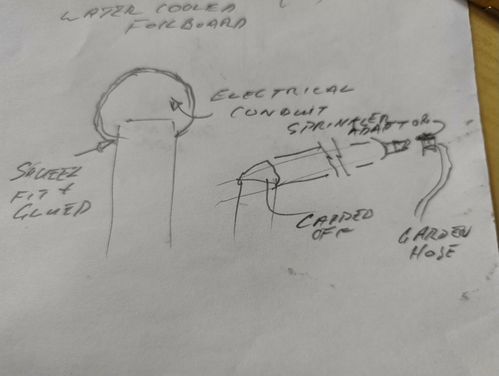

With regard to @Dave-1's last comments regarding heat retention here is a Foilboard water cooled version using misting systems or kits.
The same principal can be used to drain heat from other heat insulation materials.
Double panel version.
Single panel version.
Both using Misting Systems AKA Misting Kits.
