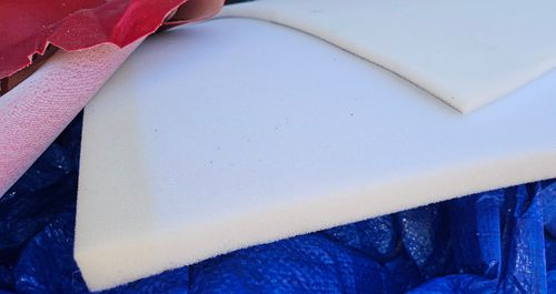

I had first bought the backing foam 50mm thick. Too thick. Back to Clark Rubber and some 25mm and 10mm foam.
Cut it to fit on the board. Fixed the bigger piece with some staples, and then joined the thinner piece with Rapid glue.
Here is where I ran a line of the Rapid Glue to join the thinner foam over the top.
and flattened it under some pressure and let it set for some time.

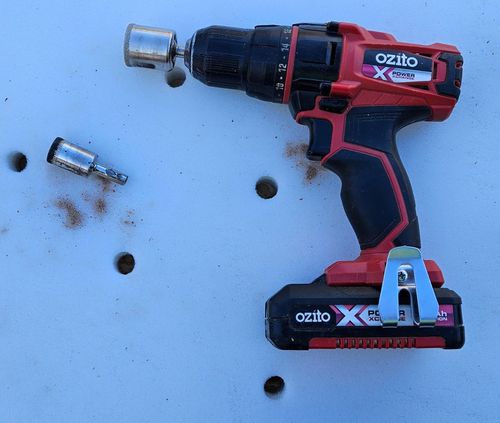

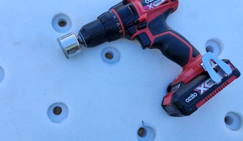

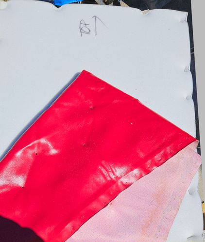

So using diamond tipped hole saws (from online suppliers in China) I cut back holes to allow the vinyl to reach direct to the base board. First the smaller holes direct to the baseboard...
Then a much larger hole, the intention was to make an easier transition for the vinyl that was being pulled down into the hole.
Hmm, and it didn't work.

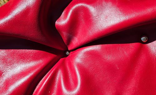

I did a couple of the 'puckers' and could see that it was just using up too much of the vinyl. So I tore off all the top 10mm sheet and went with just the 25mm on its own. That task was nowhere near as easy as it sounds. It was a nightmare to get under the vinyl and tear off piece by piece, then remove the glue trails as they could be seen through the vinyl. ARRGGHH!!!.

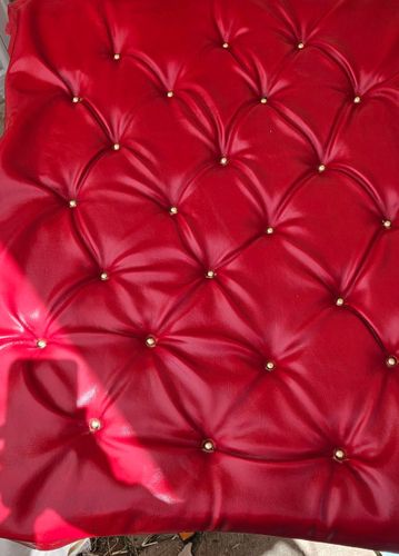

I had trouble getting the brass pins to work properly. The pin kept shifting and folding under the cap instead of going through the wood. So I drilled a 1.5mm pilot hole, nope, didn't help. Eventually, I worked out that most of the problem was my "cacky" hands (I have poor-strength injuries) were not holding the pins firmly enough to get the tack hammer to bang the pin into the wood. I worked out a system and got them all locked into place. Sigh.
It was so hot working outside that my patience and energy was fast disappearing.
and look at it all done - OK, some of the holes didn't line up, mostly because I was reusing the original vinyl so I took the holes as they were.
