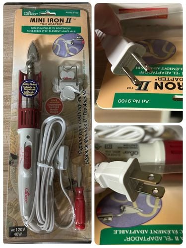

Evening all. I have purchased a mini craft iron which has a plug that is unsuitable to use in Australia. I believe it is a
Type A plug, which is a North American two-prong, ungrounded plug.
From what I have read I think it needs an adapter and also a step down converter due to the difference in voltage. I’m unsure exactly what I need and hoping someone may be familiar with best solution? Thanks so much

Unfortunately that officeworks adaptor is just a passive device for making one plug fit a dissimilar socket and has no active components for stepping down voltage. Many electronic devices are made to work on a range of voltages from, for example 100vac to 250vac and these are useful with those pieces of equipment. A heating device which appears to be what the OP has will probably simply have an element and if you apply too high a voltage it will burn out. This product appears to have been designed to solely work on 120vac so it probably would be dangerous to try to use it without a suitable transformer.
Another word of warning is to ensure the transformer is capable of delivering enough wattage as there are a number of 10w travel transformers out there and they would be overloaded by this iron. I would also look for a regulated transformer. These have electronics to control the output voltage because the output voltage on an unregulated transformer can vary depending on the load placed on it.
