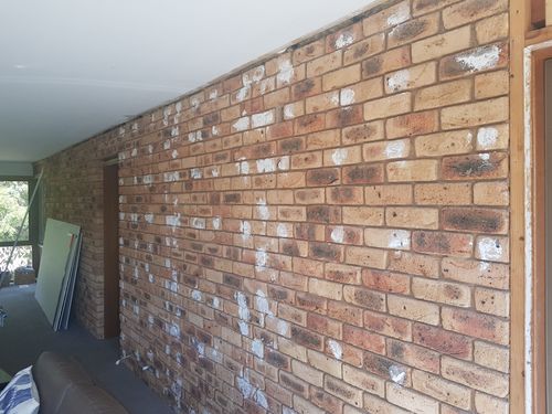

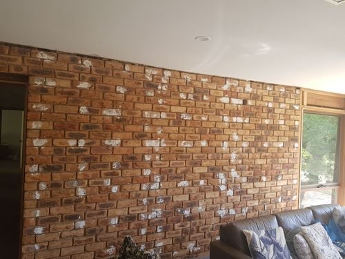

I would very much appreciate some advice to.assist me with covering the internal brick wall in our living room. I have had 2 attempts affixing plaster board with Gyprock Masonite adhesive but it has not stuck. I followed all the instructions. The bricks are quite rough. Wondering what else to try and whether plaster is the best options.

I think the issue was/is that the wall is not straight. The adhesive stuck to the plaster and the bricks but pulled apart and therefore came off the wall when I put pressure on one side (if that makes sense).

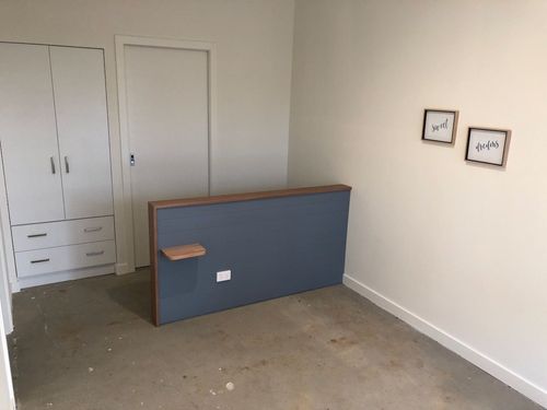

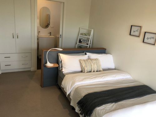

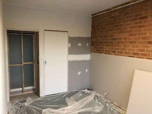

The first observation is that it appears your haven't used enough masonry adhesive.This is how I would suggest you do it which is the technique I used in a lower level space I converted into a bedroom as per the photos below..
1. You will need a 125mm angle grinder fitted with a Diamond Cup wheel.
2. Hone down all the high-points as well as the old glue spots. This is going to create a LOT of dust. So use good quality drop sheets to seal the areas from the ceiling to the side walls. A workshop vacuum will help to keep the dust to a minimum as well as being used to clean the debris afterwards. You will also need full body PPE. I straight edge will indicate any major high-points needing honeing.
3. Use this masonry adhesive to fix the new plasterboard. Run continuous vertical lines every 500mm and across the bottom at 1200mm. Fix the plasterboard sheet and prop in position. Once set do the top half the same.
