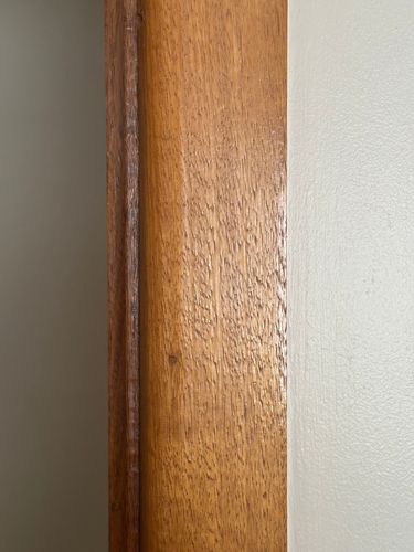

Hello,
We had the switch moved from the architrave to plaster and now thinking of a way to fill in the hole and match (as similar as possible) the current architrave. I'm not sure what type of timber to use, best way to fill the hole and match the stain/varnish.
Please advise, thanks!
Hole to be filledHole to be filledCloser lookCloser lookArchitrave of another roomArchitrave of another room

To be honest, it's unlikely you'll be able to achieve an unnoticeable repair to that hole, especially given its size and location. Even if you were to cut a perfectly sized dowel to plug it, or fill it with timber filler, it would still stand out—particularly once stain or varnish is applied. Matching the grain and finish precisely is extremely difficult in this sort of spot.
The timber appears to be Meranti, which was commonly used for architraves and skirting boards, so if you do decide to replace the moulding, that would be a good match to look for. In many cases, replacing the entire length of the moulding will actually give a far better result visually and may not be much more effort than attempting a fiddly repair.

I don't mind if it's a somewhat different, my priority is a smooth surface but it's hard to visualise how much it would stand out if I repair the hole. Maybe I can try it and if it's too obvious/ugly I'll cover it up with a switch or replace the entire length like you said. Or perhaps I'm really underestimating how poorly it will look...

In the best-case scenario, it might look similar to the below, @mody_moozy.
If the varnished surface has faded or is in poor condition, you could recoat it. However, to do so, you'd typically need to scuff up the surfaces to remove any sheen from them before overcoating with new varnish.
Remember that pulling off the whole trim section and replacing it is likely just as much work. The trim should just be nailed on, and you can remove it with a pry bar. Then you just need to nail a new section on and varnish it.

Thanks for the photo @MitchellMc. That is more noticeable than I expected, and I probably couldn't do it half as good. I'll have to rethink if it's worth replacing the entire length or just covering it with a switch.
