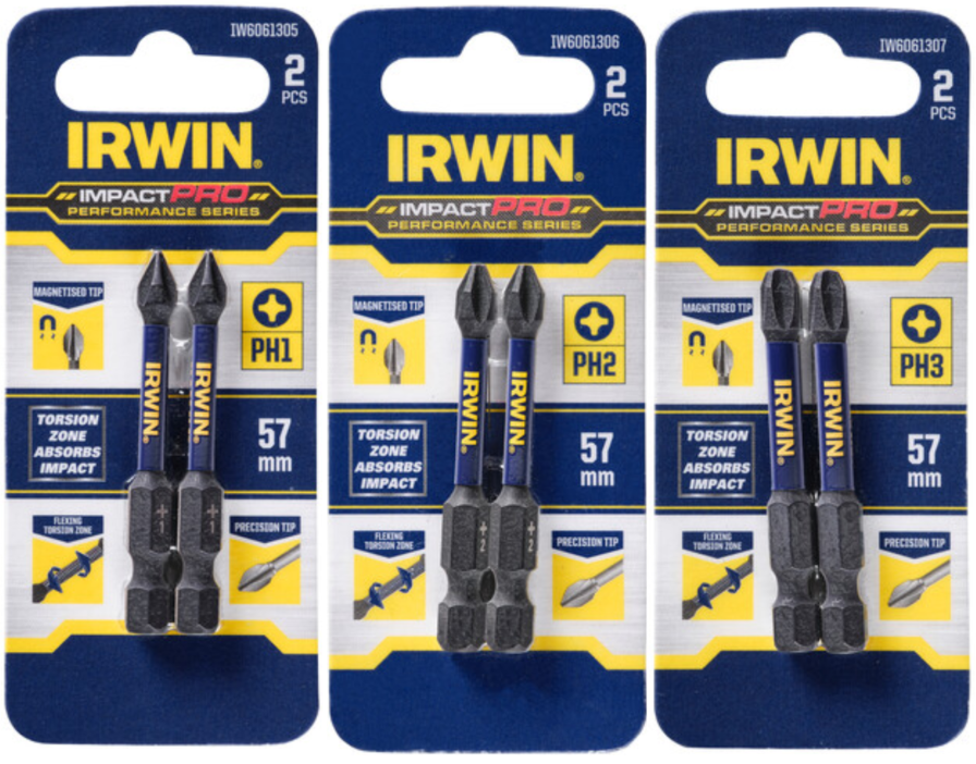

Number 1's are for fine smaller screws, number 2's suit most medium construction screws and number 3's are for larger screws. Number 2 is going to be the most commonly used when building things. Below I've shown P 1, 2, and 3 in the Irwin range. Note the differences in the tip profiles.

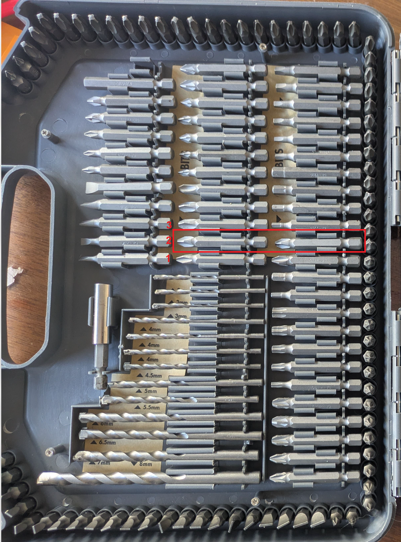

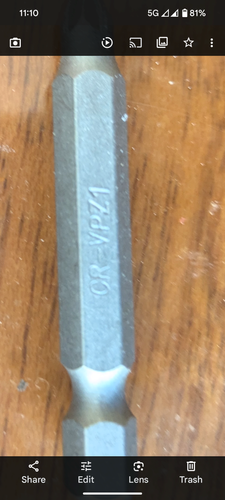

Below are the images of bit kit. As you can see in one of the pics  some code is mentioned not sure what's it's purpose

These appear to be the number 2 Phillips.

Looks like @MitchellMc has found them - bit like Where's Wally. 😁
Your 'bit' photo above is from the Pozidrive range...can't say I've ever used them much.
https://bsfixings.uk/blog/the-difference-between-phillips-and-pozi-screw-heads/
