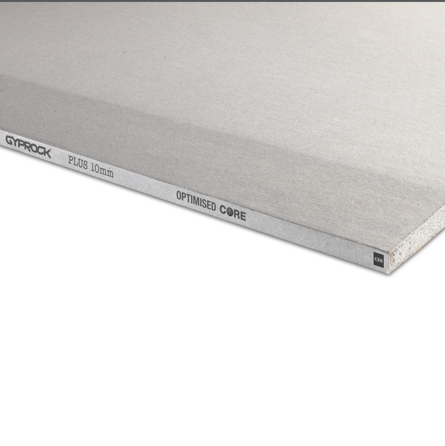

The first is that the joint in the plasterboard was not recessed, so the compound is bulging out further than it would be in a normal plasterboard joint.
You can see the slight shadow at the front edge of this plasterboard sheet. It is a very slight recess that allows for jointing tape and layers of plaster. If the plasterboard was cut so that this join didn't have a recess on each side, the plaster and tape would not have a recessed area to sit and would consequently bulge out.
