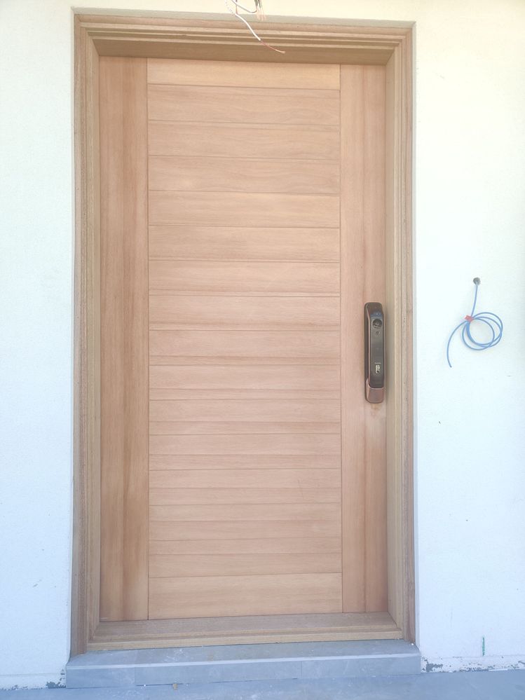

I'm sorry to hear your door was cut improperly. But from a visual perspective, had you not told me that the top was shorter than the bottom, I honestly would not have noticed it unless I was really looking for that error. Will you be painting the door white, or will you be leaving it in its natural finish? If you were to paint it a bright colour that would make the lines less noticeable, and you would totally miss the portion that was shorter.

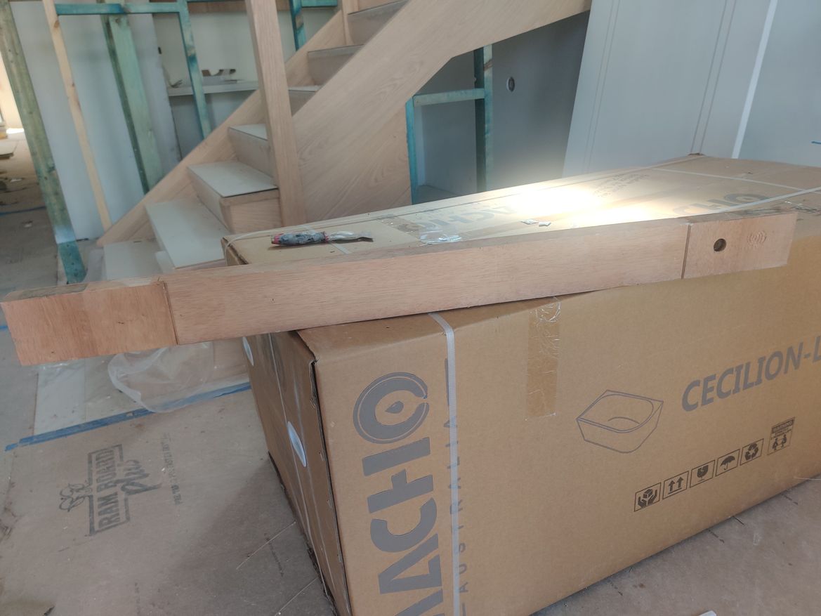

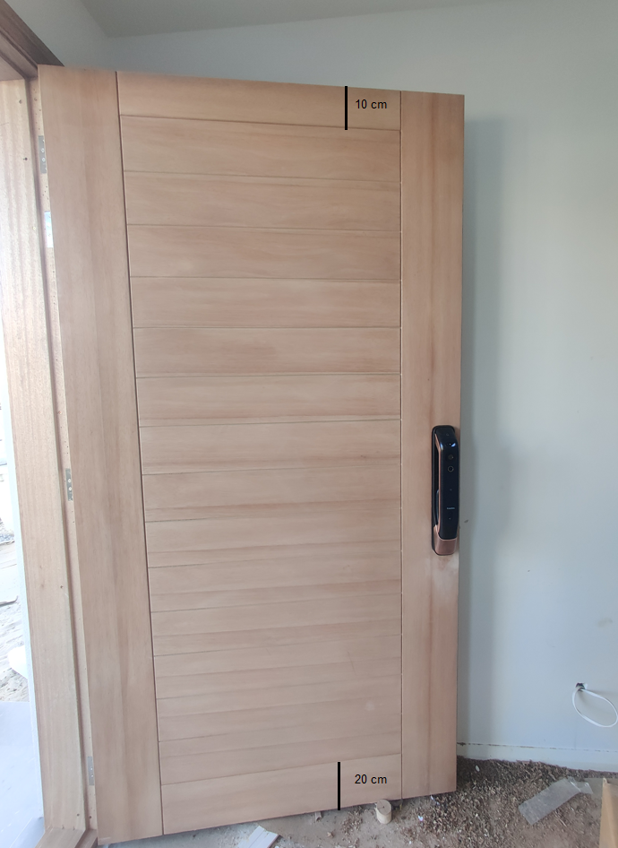

i attached more photos after closing the door and the 10cm cut piece.
i can see the top part head shaved before and after closing the door visually ![]()
this is main door and planning to do clear stain with cedar color to match my garage door color Cedar.

I'm very sorry to hear about the door, I can understand how disappointing that would be. In the photos supplied I can't visually see this from the outside when the door is closed. Can you please supply photos of the issue. And why does he want to shave the sides, I assume this is because the door ins't closing? In which case the width of the door should have been checked against the jamb opening.
If there are visual external gaps, my recommendation would be not to modify the door in anyway or adjust the door striker plate. Since your oiling not painting doing so would result in a patchwork finish.
A simple solution would be to simply fix additional hardwood/Tasmanian oak stop trim on top of the existing. Brad nails punched and filled will cover any issues the top gap. Fixing a weather sheild along the bottom will cover any issues with the bottom gap. This is the type of repair/coverup I have had to do in the past when doors I have replaced are within an out of square door jamb. Different issue, same problem and fix.

please see my second photo in my original post which shows the door closed.
Door guy said - after adding the frames around the door, space is 2300mm height for the door. so he reduced the height of the 2400mm door by simply cut the top header by 100mm to fit the door in 2300mm height ![]()
