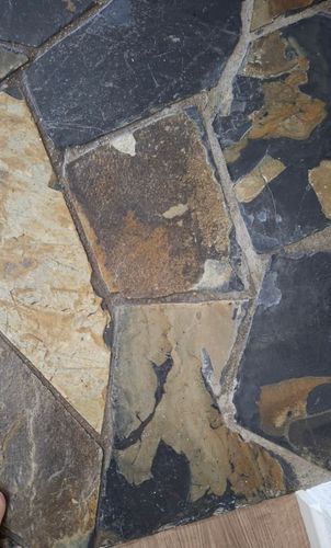

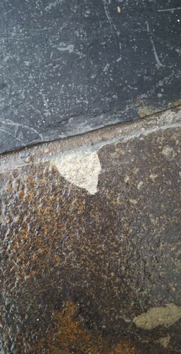

Half the floor in our new house is slate stone. Has been sealed using an acrylic based sealant.
The sealant is flaking away in patches in the main traffic areas.
I would like to fix this myself but the acrylic based sealant is only sold to tradies and having a baby at home, it seems that the water base sealant would be a better fit for us.
Should I try to remove the top layer of the old sealant first before applying the new water based one?
or only cleaning the flaked areas before applying the water based one?
if choosing the same finish as the current acrylic base, would we see a different between the 2 sealant?
I am planning on trying in the dressing room first so if finishes are too different it would not be an issue as only us will see this.

We had a similar query asked a while back and I suggest having a quick look - How to re-seal slate floor with a different brand by @Plodder. Removing the seal of the slate flooring is an involved and messy process. If chemically stripped all that chemical residue will need to be properly disposed of and if mechanically stripped it will create a large amount of sanding dust. All that dust must be kept at bay by using a shop vac and the rooms sealed from each other with painters drop sheets.
In regards to compatibility, it will be difficult to tell if the new sealer you'll be using will have the same sheen and finish as the old one. But the odds are that they will have different finishes as the old sealer has already been weathered and exposed to UV. Because it is an involved process, I propose getting a quote from a professional slate sealer (make sure it us a detailed quote). You'll get a bird's eye view of what is involved in stripping and re-sealing your slate flooring.

Id be tempted to work on it slowly, as in as parts deterioate (loose their seal) then seal each section as needed. Feast Watson 4L Gloss Clear Slate and Pebble Sealer
So pretty much, do it in small areas, see if it looks ok and blends.
The only downside is a couldnt find a smaller sample pot.
My slate has held up fine sealing wise, crack wise yeah thats going to be a large issue, at the moment its "fixed" under a rug.....shhhhhh
