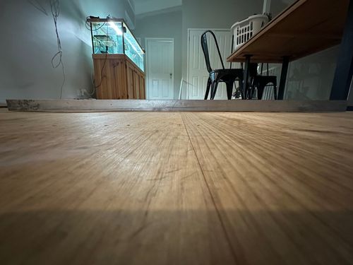

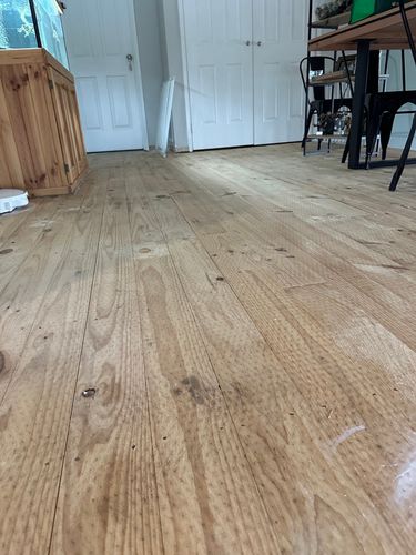

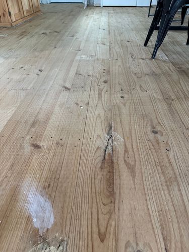

Thanks for the info! I don’t have great photos but I have attached.

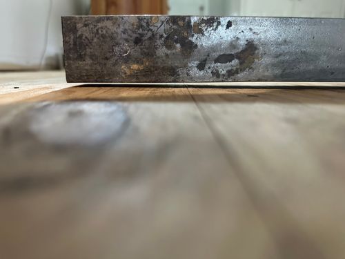

There isn’t a noticeable difference between each board, they seem to sit flush with each other.. but there is a degree of unevenness across the floor. Not sure if this photo helps, but I have this metal angle placed on the floor that shows small gaps at each end whilst the middle of the angle is sitting flush with the floor. There is a few instances of this kind of unevenness over the floor. Not sure if this is an allowable amount of unevenness for hybrid floors or if we should be doing some sort of levelling prep first.

Hi @angesh1987,
The height difference you’re seeing in the floorboards isn’t so much of an issue in itself but rather how abruptly the height changes. These sharp transitions can cause dips to transfer into the new flooring. While they might not be highly noticeable after installation, they can still subtly affect the look and feel of your hybrid flooring.
To address this, you might consider hiring a floor sander to gently sand either side of the dips. This will help feather out the transition and create a smoother, more gradual slope rather than a steep drop. Doing so will ensure a better surface for your hybrid flooring and reduce the chances of unevenness becoming a problem in the long term. I'd start by sanding the central section that your straight edge is sitting on until the two ends of it touch the surrounding flooring. That will remove the big lump out of the middle. You can then sand the whole floor to ensure an even surface.
